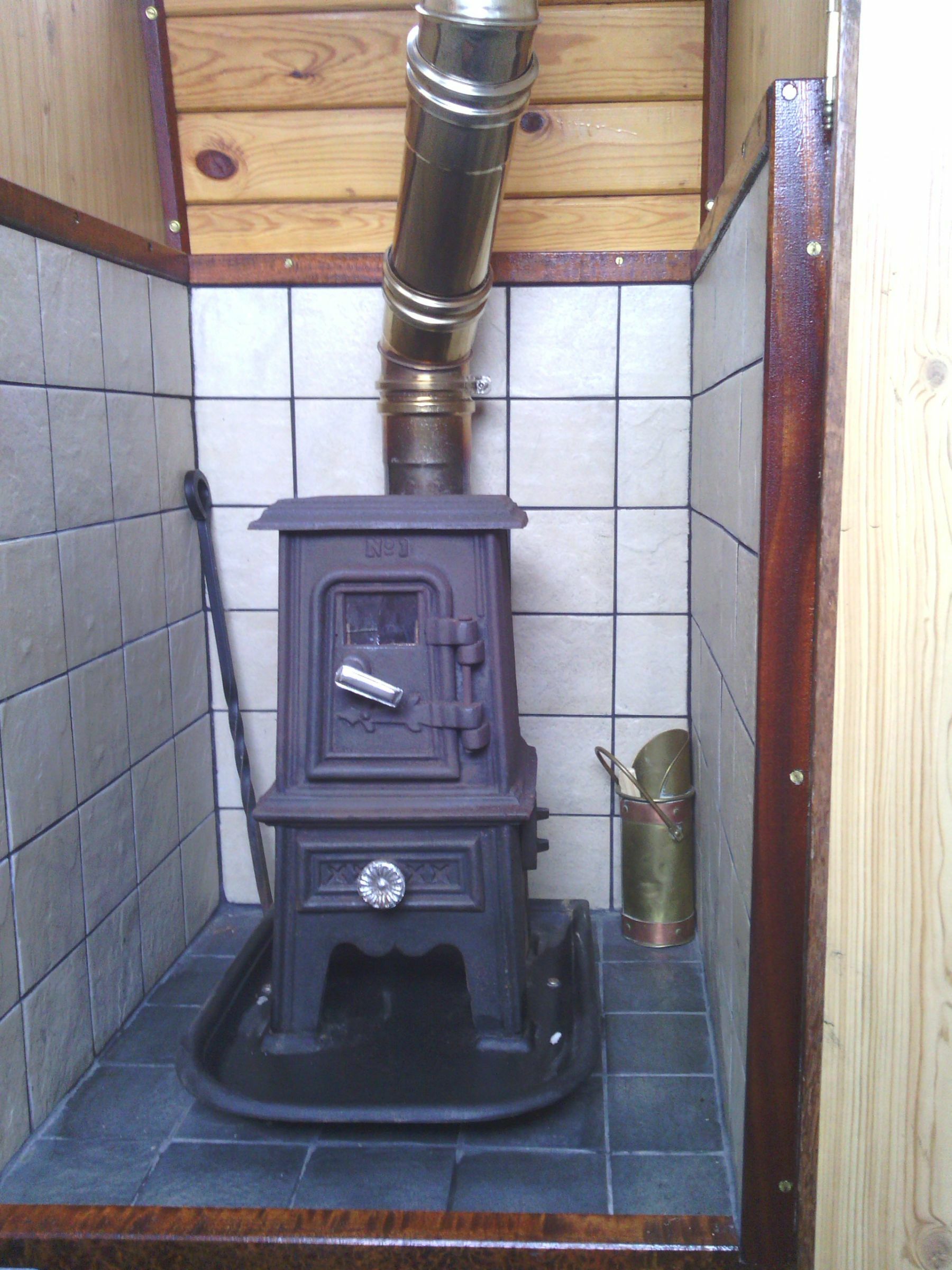

Sanddancer Posted September 19, 2021 Report Share Posted September 19, 2021 Bet it's been asked before I need to put the tiles back on the wall behind the fire that have fallen off. I've the netting and the powder but would like to just use a tube of adhesive, something I can get from Screwfix please or Wickes. Tiles are the 6*6 stone ones. Thank you Chris Link to comment Share on other sites More sharing options...
Alan de Enfield Posted September 19, 2021 Report Share Posted September 19, 2021 I used cork tile adhesive because it is flexible when dried and allows for movement due to vibration and thermal expansion. Never had one fall off. Just one supplier that came up on a Google search Cork Adhesive 0.8kg - Boards Direct Link to comment Share on other sites More sharing options...
cuthound Posted September 19, 2021 Report Share Posted September 19, 2021 The tiles in the bathroom of our first shareboat were stuck and grouted with silicone. They were still stuck firmly and looking good when we sold our share 10 years later Link to comment Share on other sites More sharing options...

Slim Posted September 19, 2021 Report Share Posted September 19, 2021 When fitting out VS 20+ years ago a book on fitting out, can't recall title recommended Cork tile adhesive. I went against that advice and used ordinary waterproof tile adhesive for shower, bathroom wall tiles, galley splashbacks, stove heath and stove surround. None have fallen off, yet😀 Link to comment Share on other sites More sharing options...
Tracy D'arth Posted September 20, 2021 Report Share Posted September 20, 2021 Cork tile adhesive is highly flammable. Link to comment Share on other sites More sharing options...
