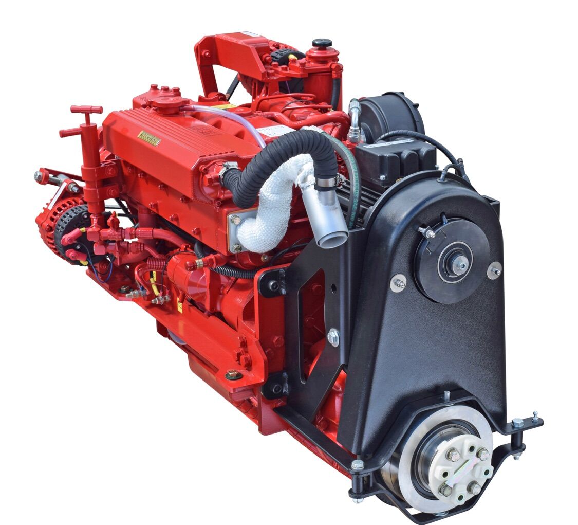

So what engine are you using? Something like the Beta hybrid???
No, it's a series hybrid (what people often call an "electric boat") -- 9kW diesel generator, 48V 700Ah (35kWh) LFP battery bank, 15kW PMAC motor/controller, 10kW inverter/charger, 2kW of solar. No gas, cooking is electric. Heating is a diesel (hopefully HVO) pressure-jet boiler for the time being, suitable heat-pumps aren't available yet.
So an electric boat with a generator to charge the batteries when there’s not enough solar, like the normal electric boats Finesse are building which everyone just calls an electric boat as you say. Fitted with one of these motors:
and not what most people regard/know as hybrid, one of these:
What Finesse build -- and are doing for me -- are series hybrids because there's a diesel generator on board.
It's the correct term, it's what they call them -- or "electric propulsion", which is also correct. The energy source can be solar, or plug-in, or the generator.
The one you showed is a parallel hybrid.
