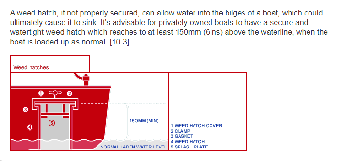

Does it have engine room vents in the Hull ?
An overplated Springer sank on the Thames as the additional weight meant the vents were too low.
Port of London - River Thames (pla.co.uk)
Maybe you can use this as a negotiating tool.
From the Boat Safety Scheme :

The survey notes 2 vents are a little low and need sorting as below the 150mm limit. These could be moved or looped up ?

The advisory for hull-fittings (vents, drain pipes etc) is actually 10" (250mm) it is only the weed hatch that is allowed to be 6" (150mm) as it has a sealed lid.
Again, from the BSS :
To reduce the risk of your boat sinking if it keels over or is excessively weighed down, it's a good idea for privately owned boats to only have openings which are at a height of at least 250mm (10ins) above the waterline. Where openings are necessary below this level this risk can be reduced by ensuring that these openings are permanently and securely connected to ducts or pipes, which are watertight up to that level.
Self-draining cockpits may not be able to meet the 250mm (10ins) recommendation but, for privately owned boats, it's a good idea to stop water getting into other parts of the hull by incorporating non-return valves in the drains and/or having bulkheads or cills up to a height of 150mm (6ins).
