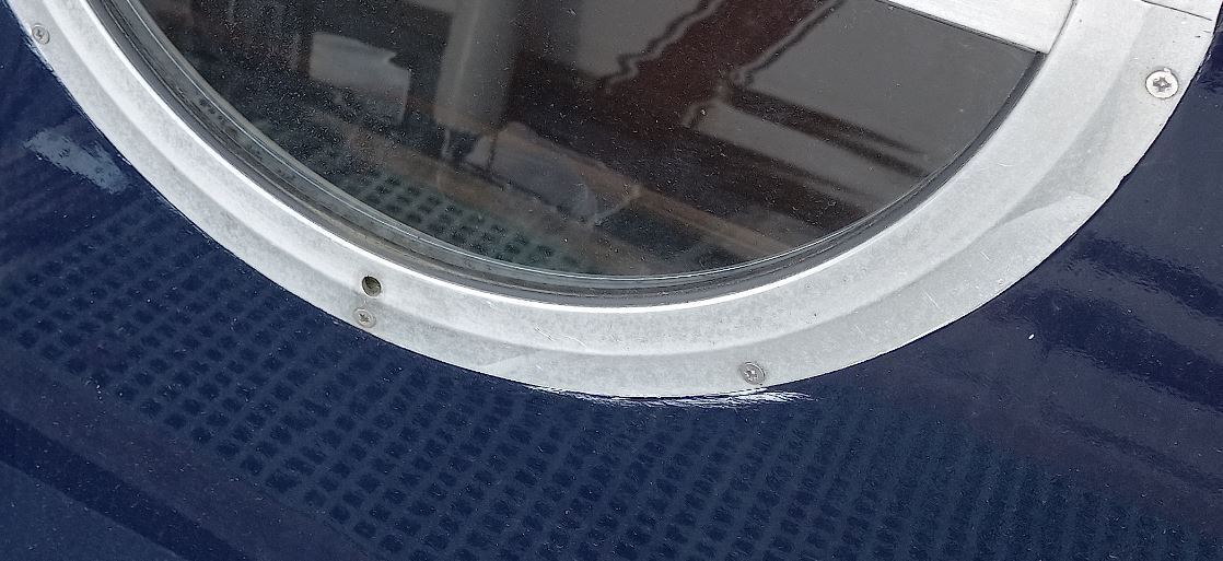

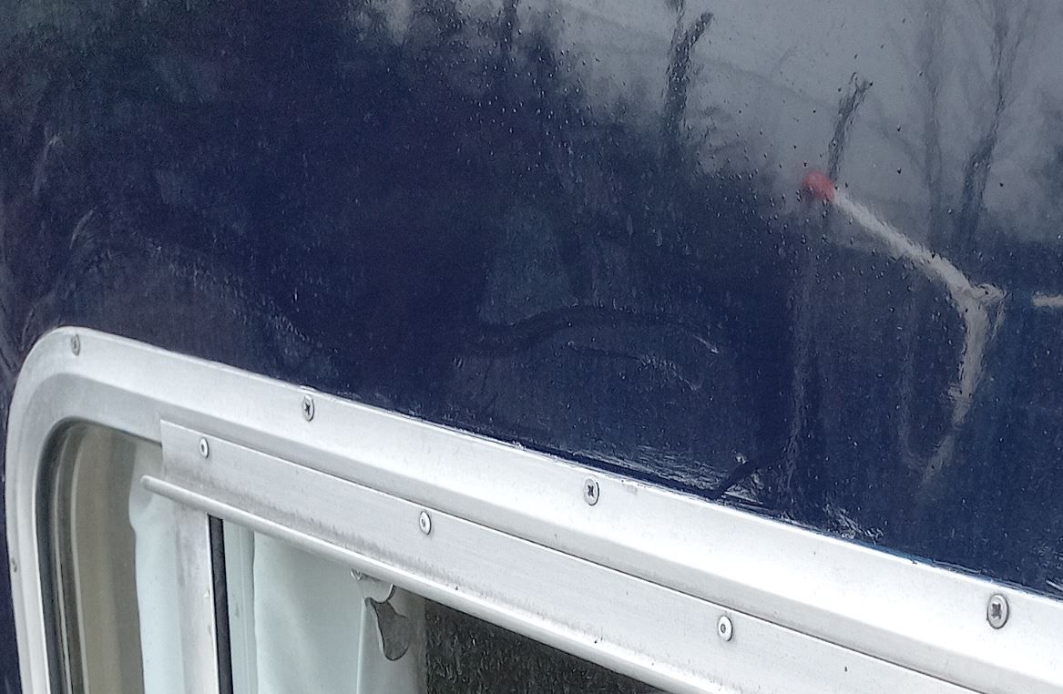

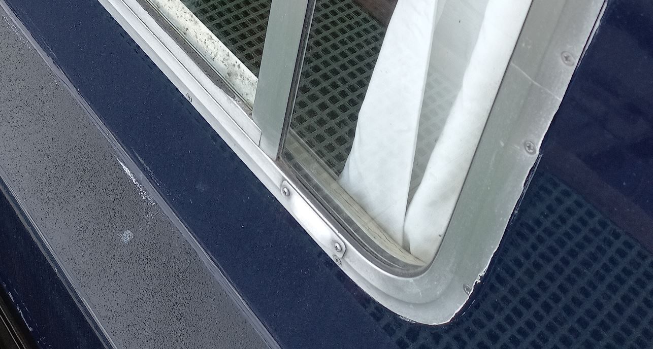

It's evident the windows weren't removed as I can see the circular brush marks around the portholes, and also paint on the window frames which I was able to pick off.  There also appears to be little specs / rash within the paint, is how I'd best describe it, visible too.
A survey wasn't done during the time it was out of the water or when the current owners' bought it 3 years ago.  What concerns me is the finish doesn't appear too brilliant.  The cosmetic cabin sides I can deal with, but if this was a rushed job and done to the standards the photos suggest, then what concerns me is the hull sides.  Was it prepared properly?  Did they allow millscale to develop before painting it?  And what are all those white marks all over it?

Millscale won’t develop after blasting, you may get a little flash rust, but that’s easily removed.
It looks as though you’ve got one of two things, microblistering or solvent pop. There’s plenty written online about the two. I’d be more worried if it were microblistering as it will only get worse.
Hope this helps.
Not great is it. Cutting in around windows is amateurish.  I would think that the hull paint is different stuff than gloss topcoat, its what I have on my boat anyway and you certainly wouldn't use it for its attractive shiny appearance.  Sometimes ordinary paint does that if you apply it on a hot day and the brush marks look as though the paint was drying before it had 'flowed'.  If the hull paint below the waterline is at all iffy I fear the vendor has wasted a lot of money. I guess the only cure for the topsides is flatting the surface down and another top coat. Is it on one side only? if so it could be that the sun was shining on that side.

And for £10k on a 45ft boat, without having taken the windows out, it's terrible.
A paint job, costing £!0k should involve all windows and fittings being removed before stripping and re painting. As already said cutting in (badly) around windows is very amateurish. Personally, I would walk away, unless you are prepared to spend another £10k getting the job done properly.  I know it was nearly nine years ago, but I only paid £5k for a 52ft boat to be repainted, and that involved everthing being removed, cabin taken back to bare metal, and far more than three coats of paint applied. I saw the boat eighteen months ago, and it still looked newly painted, and still very shiney

I agree with other comments. For a £10k job, the windows should have been removed. And the fact that you have paint on the windows and cutting-in marks suggest lack of attention to detail , and skill.
I've prepped and painted boats that originally had similar symptoms. The effect could go all the wall back through the layers, and even to the steel. This may be more characteristic of single part paints. Two pack could resist the backward effect.
