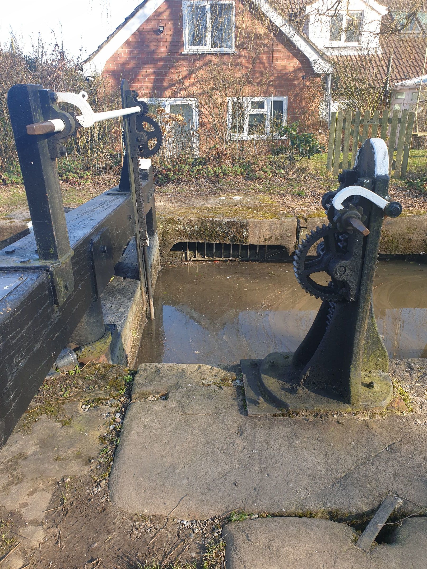

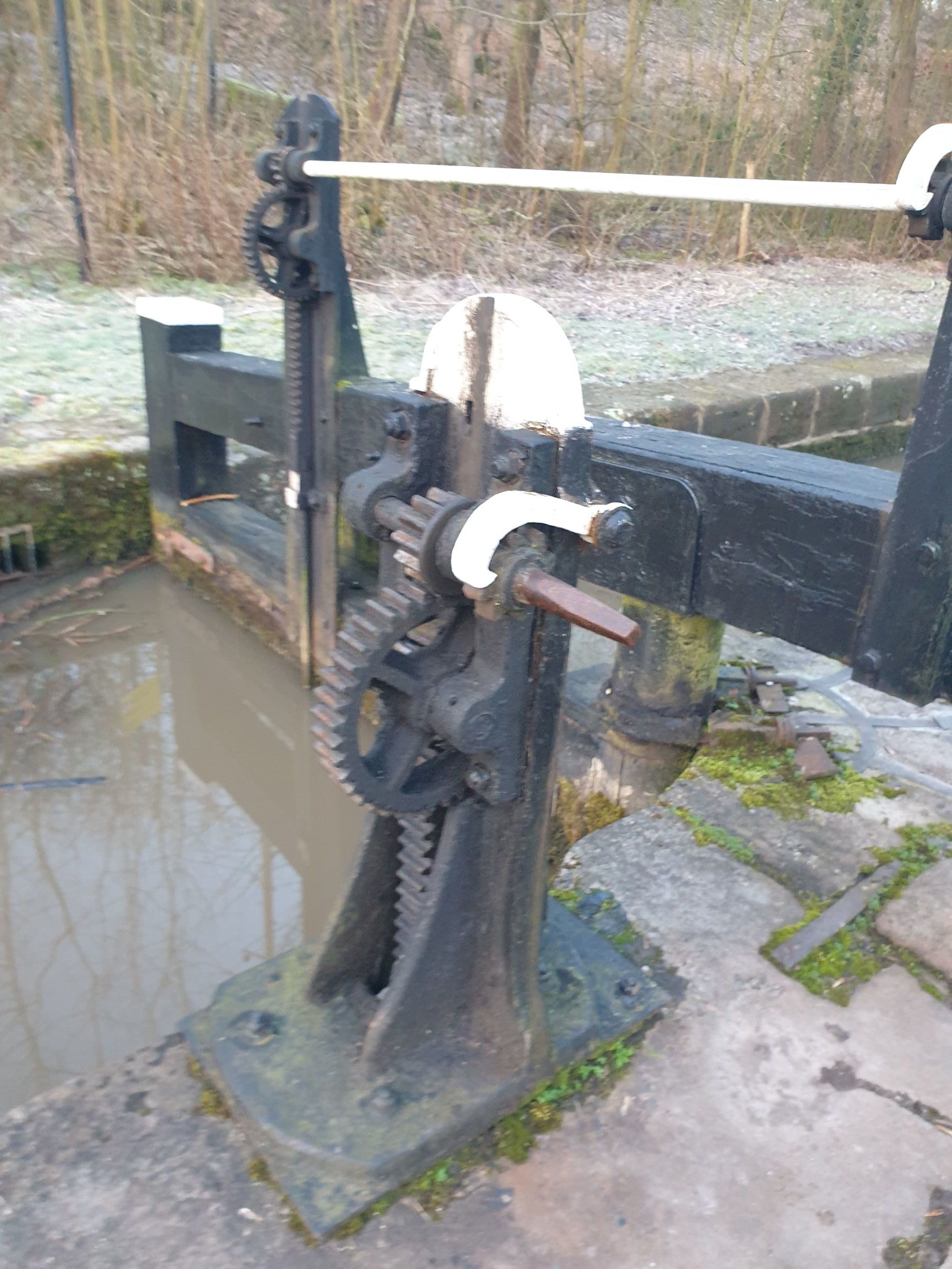

Attached two pictures of paddle gear at Marple. When boating as a kid and as a teenager this was "standard" paddle gear and other types were "different", some obviously so (Leeds and Liverpool, Hatton) others more subtly so. Over the decades since I've realised that it's largely confined to Cheshire and the North West and that it isn't really traditional. Overall though it seems to be very satisfactory, unlike the other "innovation" of the period, hydraulic paddle gear.
Where did it come from and why?
As you know, the centre paddles on the top gates at Marple aren't as originally fitted, there then being two off-centre. Those single new ones are I feel are not ideal and rather vulnerable and exposed to boat fore-ends, although some canals did have paddles like that, eg T&M (with long spindles under the balance beam)

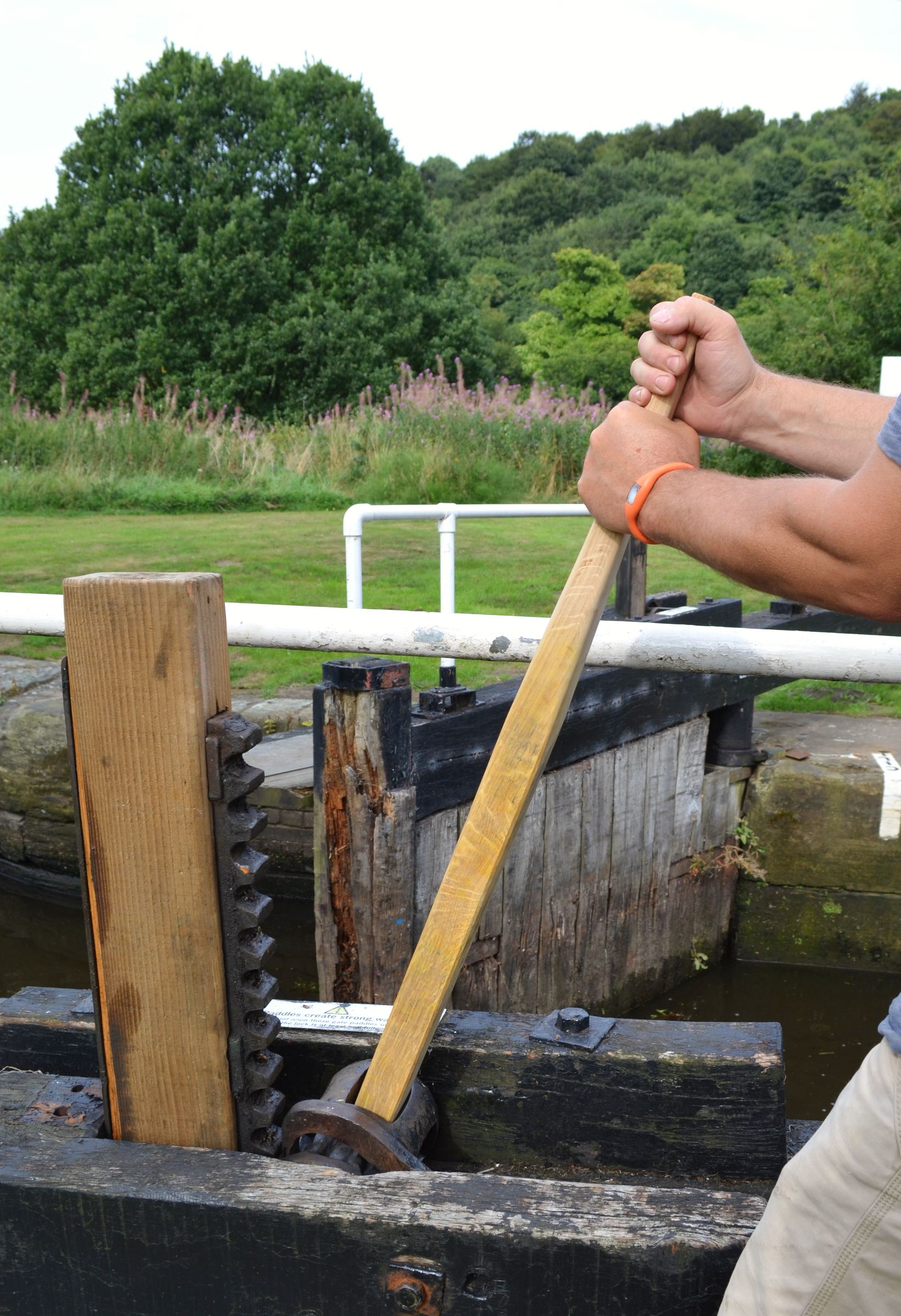

The geared down Marple flight gear is very good indeed.  Where there the windlass pinion acts directly on the rack, the gearing is rather high and the small number of  teeth on the pinion manes there is limited contact area.  The side-by-side double racks address the engagement issue and introduce a delightful waggle in ascending or descending rack.  The profile of the gears is not generally involute (I think I have that right) which is not ideal form an engineering perspective, but does help with the distinctive noise.
Back to the Marple type, I wonder if it was not a reasonably recent adaptation of the direct drive type?

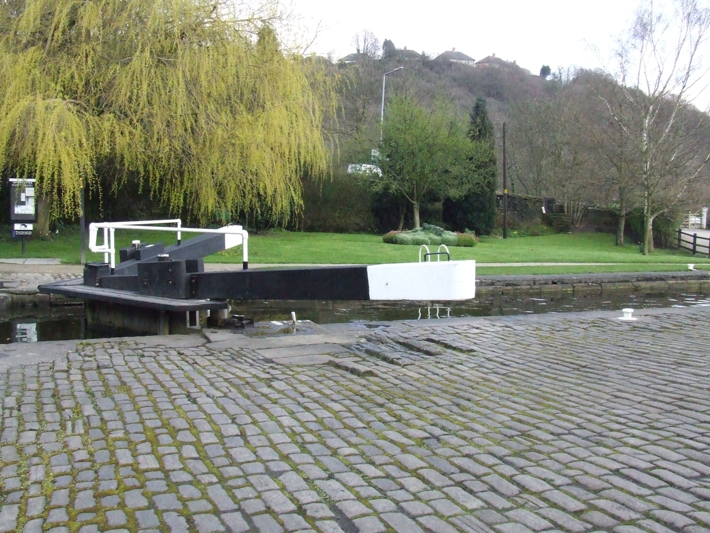

  • magpie patrick changed the title to The Paddle Gear Thread (formerly Cheshire Paddle Gear)
I tend to think this is the top lock at Calcutt (Wigrams) because of the direction the balance is/was pointing and the double handrails on the bottom gates behind the boats - where a public  footpath crosses. This may have crossed the canal by the nearby drawbridge pre-widening.  The captions on many of these CRT archive pictures aren't always spot-on.......
Link to post

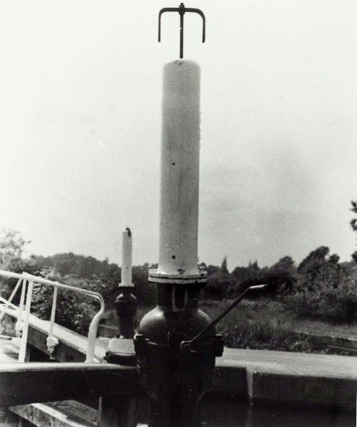

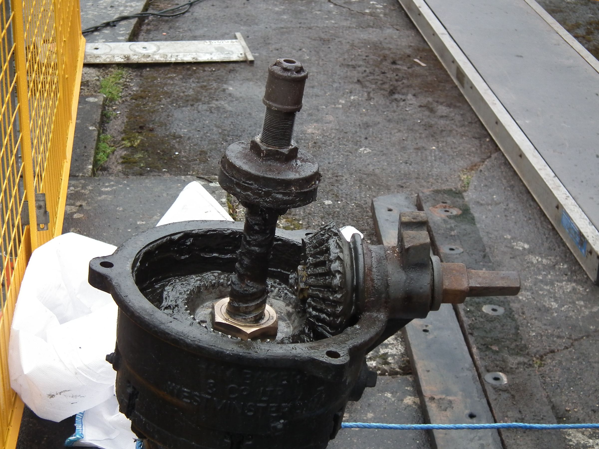

On 12/03/2021 at 12:48, Ray T said:
A couple of Ham Baker for the album.
Note "while closing is by gravity." :captain:
Do you have any information on what the spindle locking mechanism was like ?
Link to post
