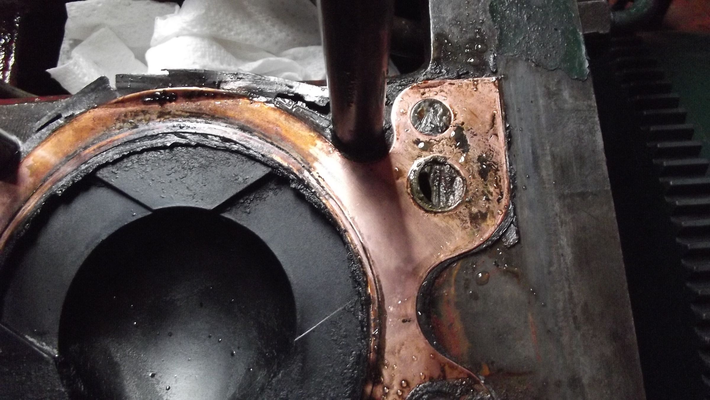

Ive had to have several head gaskets bespoke made over the years for my 2VSH.  All with various success and failures.   The OEM gaskets were made from asbestos copper sandwich.
I'd be interested if these are a composite build or just solid copper?
Below is a picture of my 1st graphite sandwich gasket that failed and also blocked one of the coolant passages in the head. (leading to a good cooking!)
Thanks!
Very sorry to hear that.
Our gaskets are a based on the originals using an Asbestos replacement material and are being made for us by a 3rd party firm who have over 50 years experience manufacturing head gaskets.
That looks like the asbestos inner was made too thick for yours. It’s surprising just how much they can spread out once the heads are torqued down!
