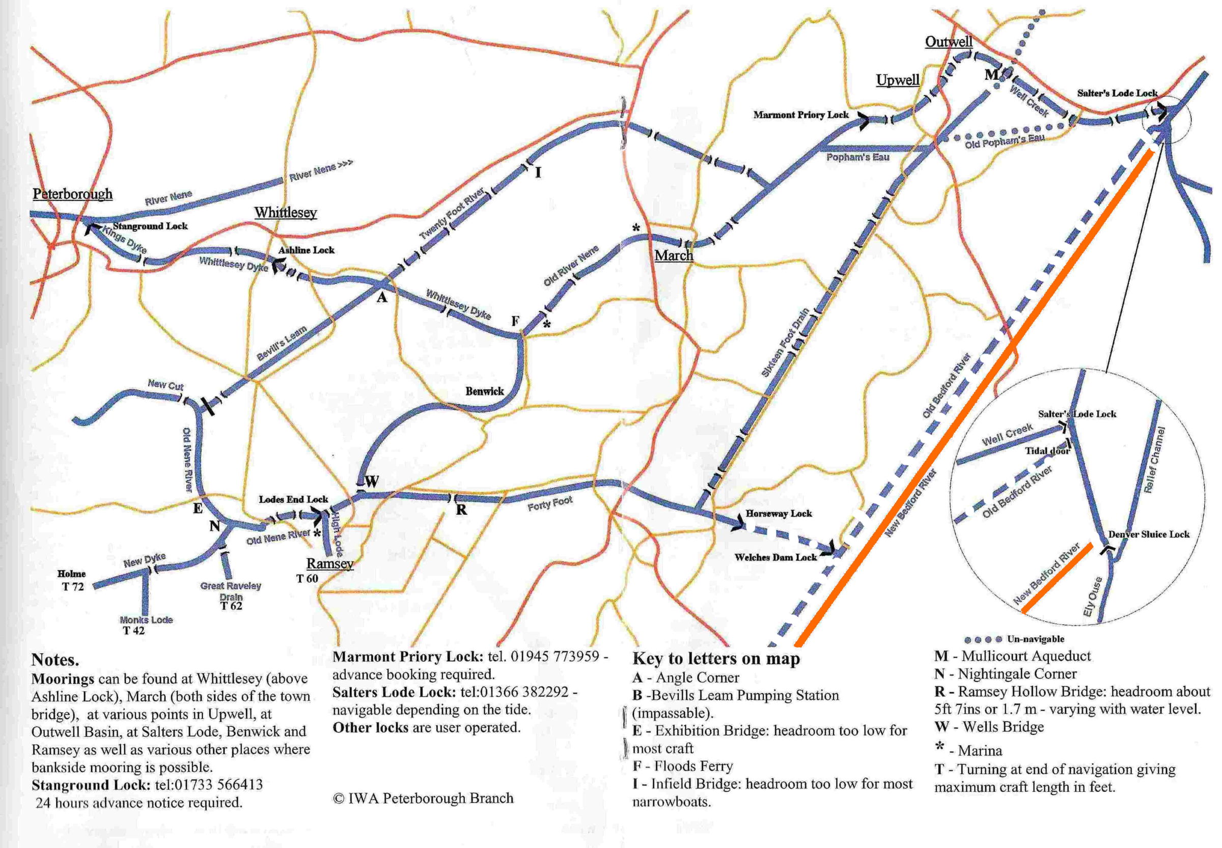

So based on what was said above about the un-navigability of forty foot above Horseway lock, and of the Old Bedford being unnavigable for full size craft, and the New Bedford being hazardous due to shallowness, does this map (modified from IWA peterborough) reflect an up to date picture of MLN navigability?
More or less. Notes E and I denote low bridges that very few NBs can get under. The bridge at R was raised about 15 years ago and is at a more normal height. The MLC map is the definitive source.
I measure my boat's air draught as 5' 9". According to the headroom map on the maps page of the MLN site, Exhibition Bridge 80 (E on the above map) has only 5' of headroom.
Given that Bevill's Leam is blocked by the pumping station, that effectively cuts off Yaxley for most craft, right?
And Ramsey, Great Raveley Drain and Monk's Lode are accessible but will require reversing in one direction.
There's a sluice on Great Raveley Drain that is well before the indicated head of navigation, but I can't find any evidence that it's passable - @Scholar Gypsy you said in this post that you got up to the sluice but the signs (not legible in the photo) discouraged you from passing it.
The MLN is starting to look a bit less extensive than first glance!

Unless I'm looking in the wrong place, the navigation map (2013) on their website doesn't really seem definitive. This shows forty foot drain and new bedford river (though they are outside ML so I suppose that could be overlooked). But it also shows Old Popham Eau as navigable to Nordelph, which is at odds with every other map I've seen.
I actually had in mind the bridge map. I think the eastern part of  Popham's Eau is navigable, it just doesn't connect to Well Creek at Nordelph as the levels are obviously now different, and there is no lock there.
I wouldn't go under the control sluice at Great Raveley drain, it is clearly marked as the end of navigation and the sluice gates can move without warning, in theory!   The waters to the south of it are shown as non navigable on the map.

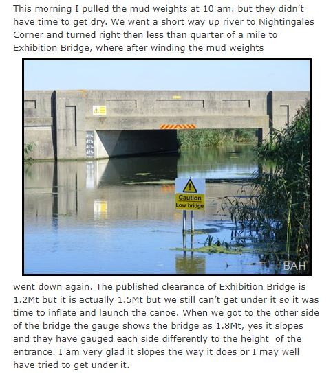

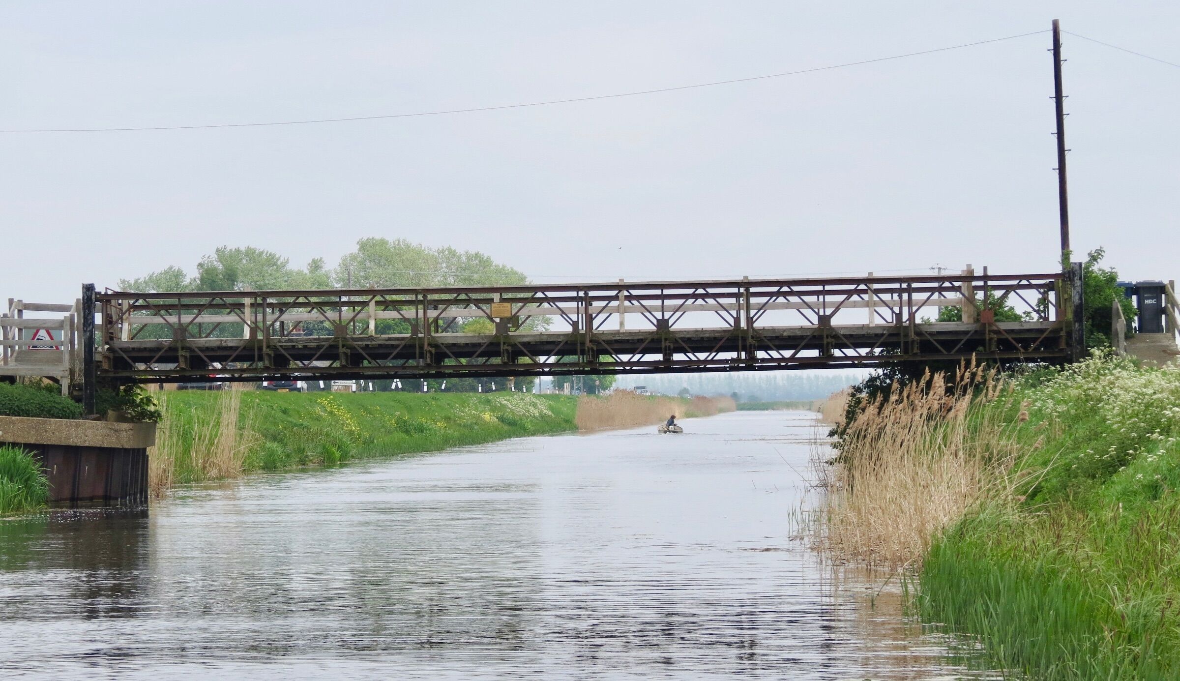

This is the bridge I on the 20 foot
 60
And this is E on the map

The MLC have put one of their new moorings the wrong side of Exhibition Bridge, don't know who will ever use it?
People in canoes, it will also prove more moorings are not needed, bit like the lock at Brandon, why make it longer there is no record of longer boats going above it
