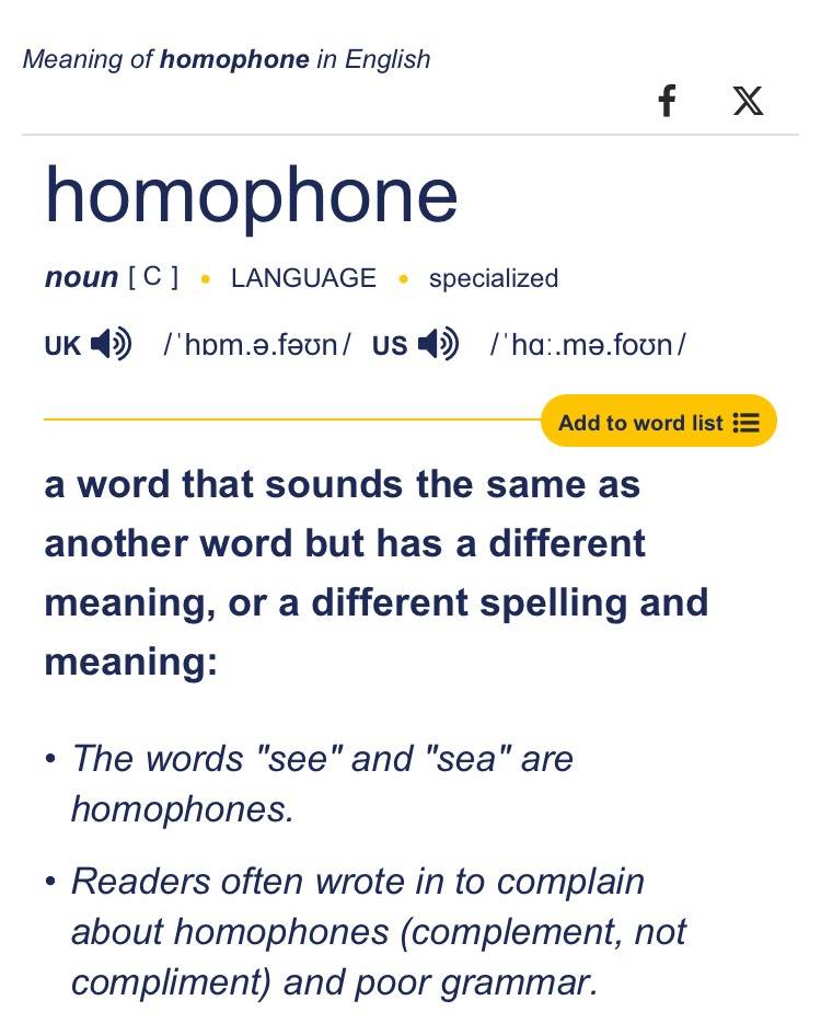

BoatingLifeUpNorth2 Posted April 30, 2025 Report Posted April 30, 2025 21 minutes ago, ditchcrawler said: Where is Gyb Ho when you want him ? Gyb Ho, “Spanker” that’s a homophone not an acronym.
