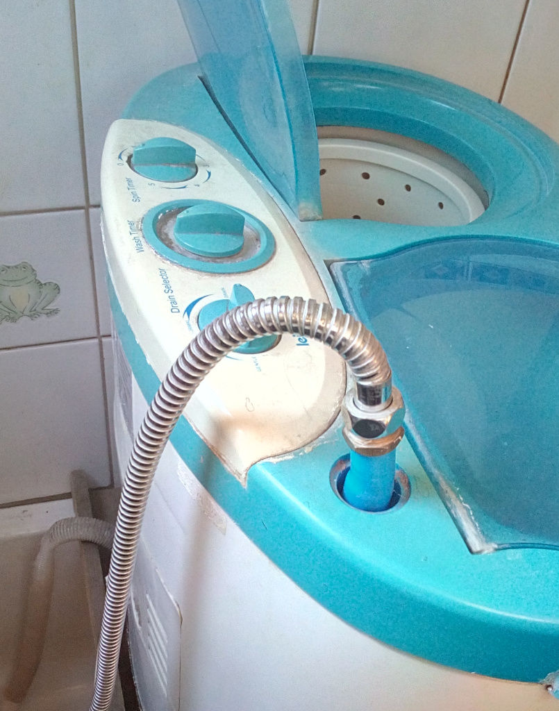

That’s what I use on boat, it works well of inverter and in summer solar more than copes. I store it under bed then it sits in bath and I use shower to fill with warm water. One thing is liquid detergent is better as powder can still remain in small flecks after wash.

After the warm wash detergent and spin dry, I put the laundry back in the wash side with cold water for around 5 minutes of agitation, then dump the rinse water and spin out again. Repeat for a second rinse cycle and all the detergent is gone. It is probably not as efficient on water usage as the most frugal of auto machines, but is very effective. For faff reduction, I set mine up on a wooden tray set to sit over the bath tub. The power comes from a waterproof socket. The water in comes from the flex shower hose on the mixer tap, which has a 3/4bsp connection to a short length of hose in to the machine, to give easily selectable hot and cold, or a mix for a cooler wash. Waste water goes in to the bath, then overboard via the Gulper. All easily and quickly removed and put to one side in the Spring when I have my bath. Only a few months to go now! ?

This is pretty much what I used to do.  Except, to fully rinse could take up to 5 (or more) loads of water.  Add to that, that you can only fit a few things in at a time, espcially in the spinner, and I found that washing took up my whole evening once a week.  Now, I just stick the machine on at some point during the evening and leave it.  Then hang it up when I'm off to bed.  I would NEVER go back to a portable twin tub.
The other problem I forgot to mention is that twin tub machines aren't big enough to do big items like duvet covers.  So I still found myself having to go to the launderette.  What's your solution Jen?
