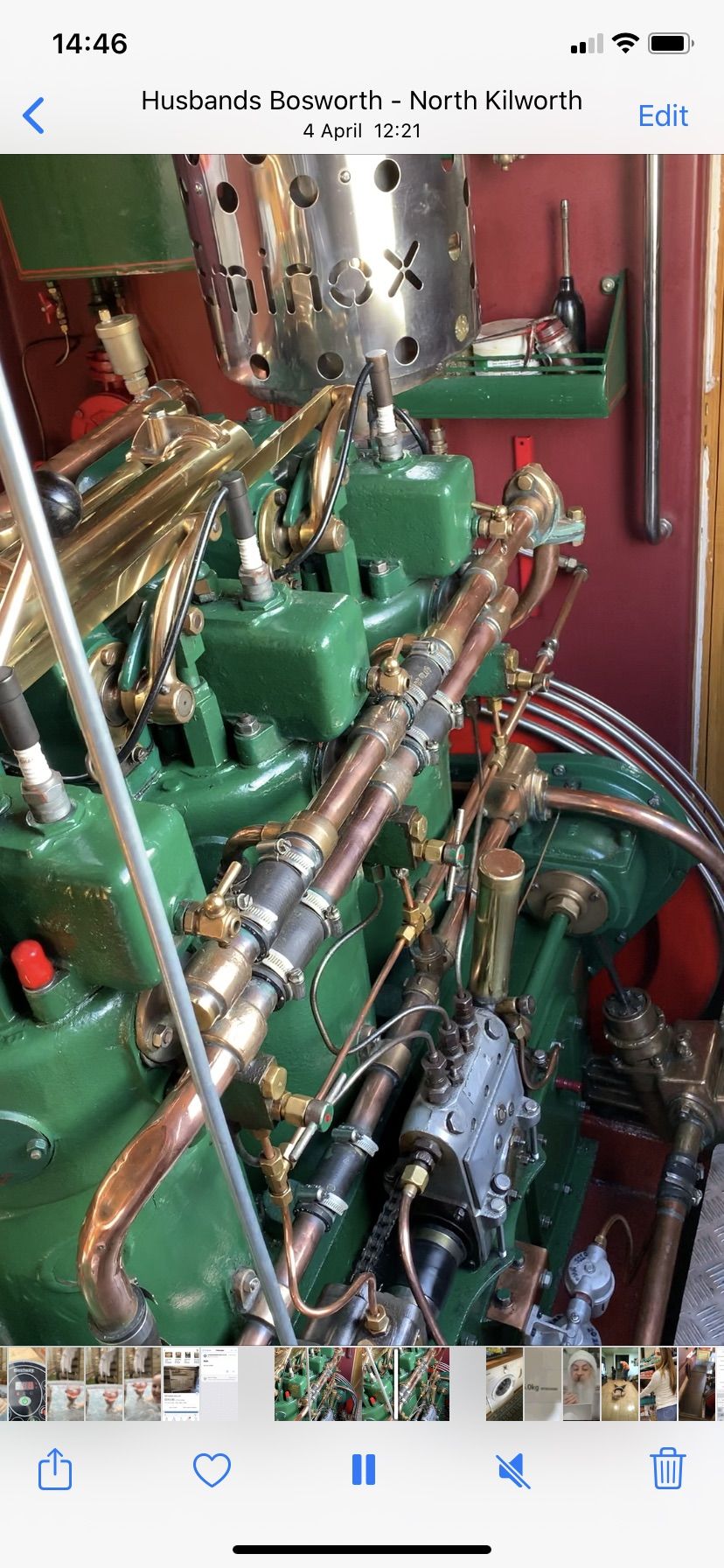

Been running my engine today to double check the charging systems.
What I noticed is that on the cooling water lines one cylinder was significantly hotter than the other two.
The Cylinder blocks themselves all felt about the same, just the outlet pipe.
I have put in some engine flush to see if there maybe a blockage, but anyone had a similar issue before.

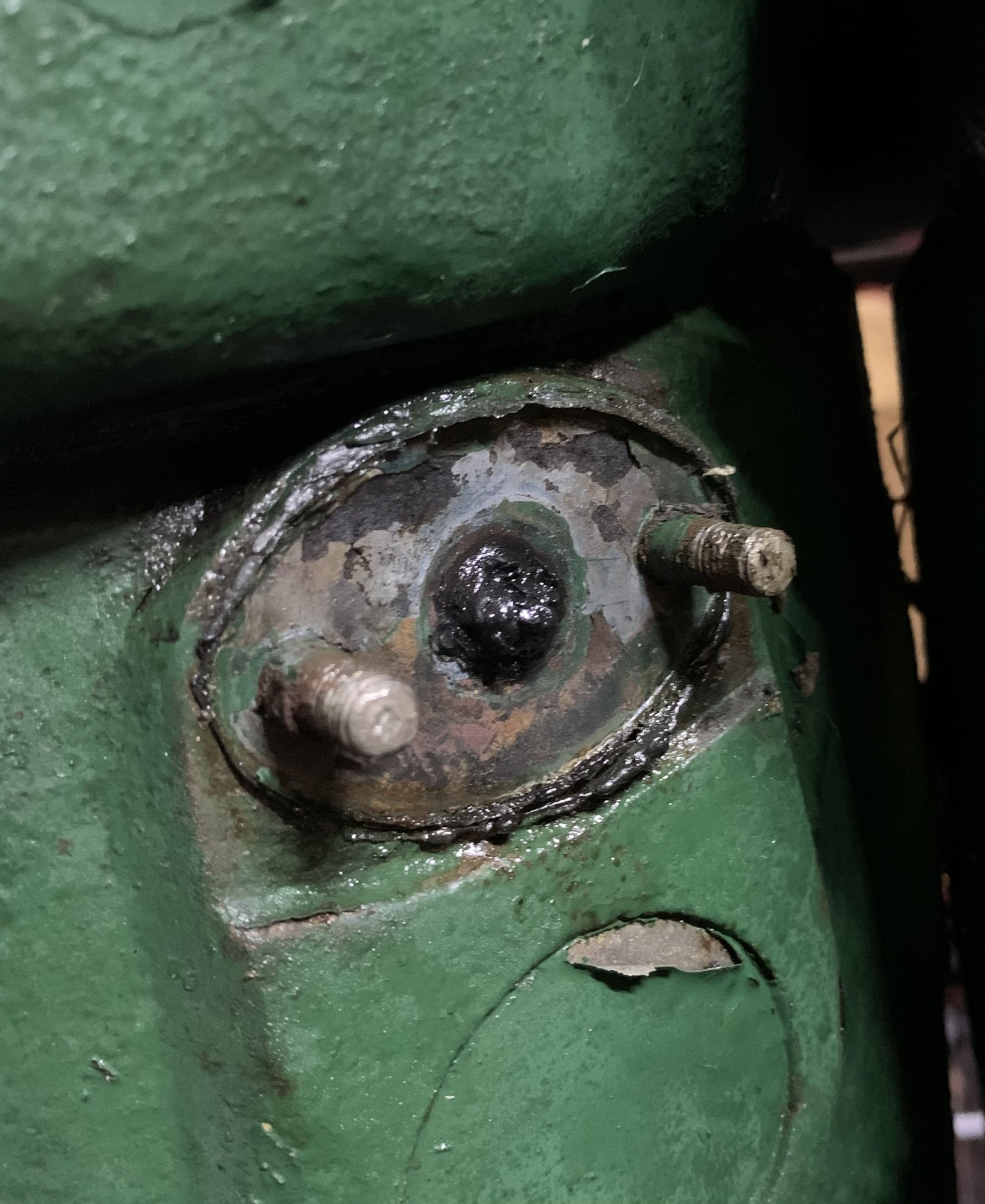

  • 4 weeks later...
35 minutes ago, Martin R said:
Removed all the cooling rails, found the cylinder and head outlet pipes severely restricted with sealant
"Severely restricted"?  Is there any water passage there at all?
Link to post
Some years ago we acquired a part dismantled J2 . One cylinder head was cracked and the engine had been seriously overheated. The owner had given up with it, especially as it was only hand  start.I completely dismantled the engine and found that the water pump inlet flange had been siliconed, much as in this case. There was about 60% blockage of the water intake with white silicon- I took it that  this was the cause of the overheating and  damage to the engine.😩
