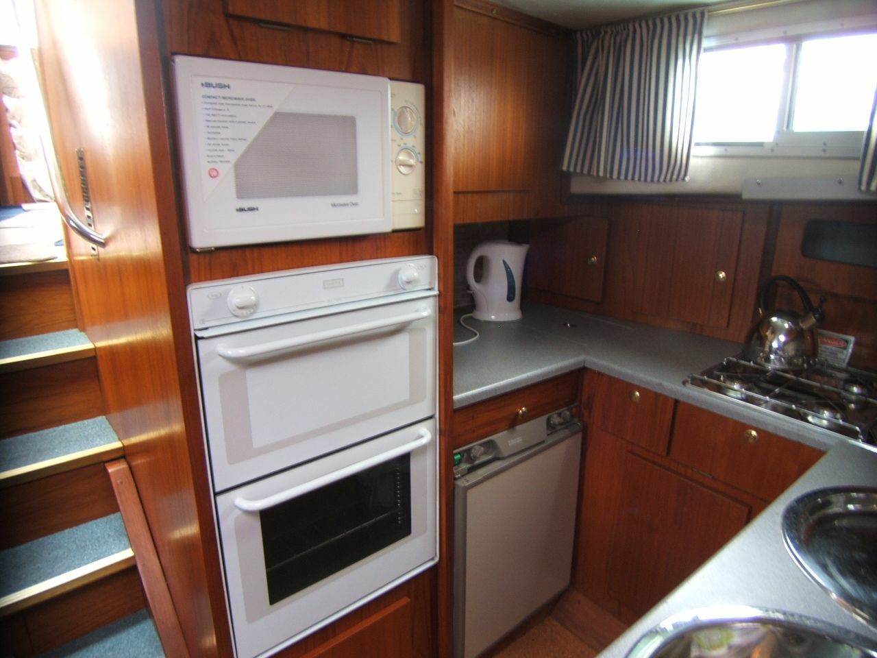

3 hours ago, TNLI said:
10 mins of 800W from my microwave will give the second battery a fairly good kicking too.
800W at 12V is about 66A so, in 10 mins, will draw about 11Ah. Assuming your battery bank is a few hundred Ah, that is hardly a "fairly good kicking".
 I wonder if that is 800 watt plated consumption or 800 watts cooking power. If it's the latter then he is looking a close to 1600 watts consumption but still 22 Ah is not a good kicking for a  decent battery bank. However, we must remember the OP seems to have sea boat so perhaps out 300, 400 or 500 Ah plus battery banks we use just for the domestcs may not be so common.
Be it an 11Ah or 22Ah demand that is still far away from a 'good kicking' even for a single 110Ah battery.
