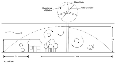

When you're thinking about the domestic / marine wind generator then it's not so must high winds or winds speed that you need to take into consideration it's the quality of wind you might get at your mooring. Wind turbines and generator only work at their optimum efficiency when they are powered by smooth air flow, which is why the big wind farm are up the side of hills, out at sea or wide open spaces, rather than urban or wooded areas. They type of wind generator that you would be considering are the type that work well on yachts because they are mounted up a mast and the air flow is undisturbed, this unfortunately is less likely to happen on a canal; that's not to say that it can't happen but it is definitely something you have to take into account.
The marine generators that you can get these days are very much quieter that they used to be and can be quite handy if you can get them set up in the environment that they like best. I strongly recommend that if you want to research these little beasties that you look to yachting videos on YouTube but that you also look into how quality of wind flow will effect whether or not a wind generator will work for you in the places that you tend to moor.

VAWTs are vibration free (or should be) but some models were known to generate an annoying tone. Glad to hear yours isn't one of them! The Rutland, like most HAWTs, is prone to vortex shedding from the trailing edges of the blades, hence the amplitude modulation (helicopter impressions) and flapping sounds.
All small turbines suffer from the basic problem of wind shear, though: you can't get them high enough to avoid ground effects!
