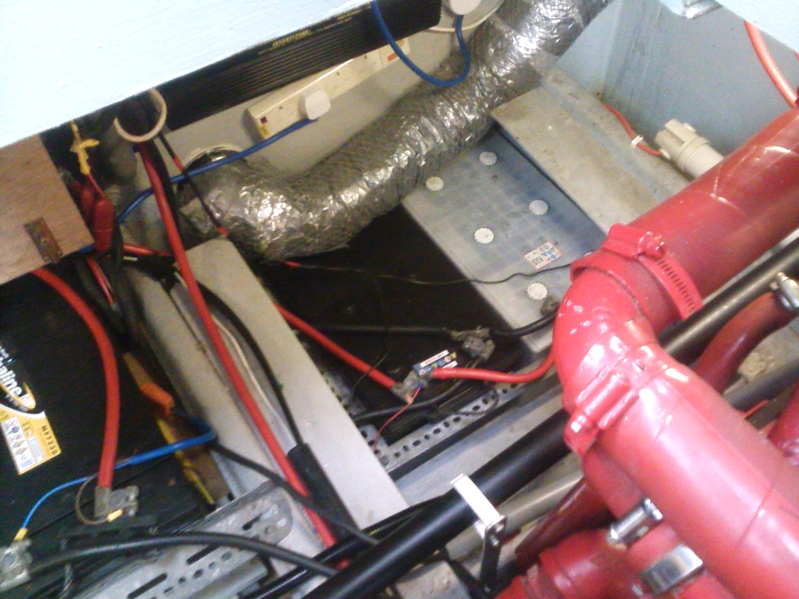

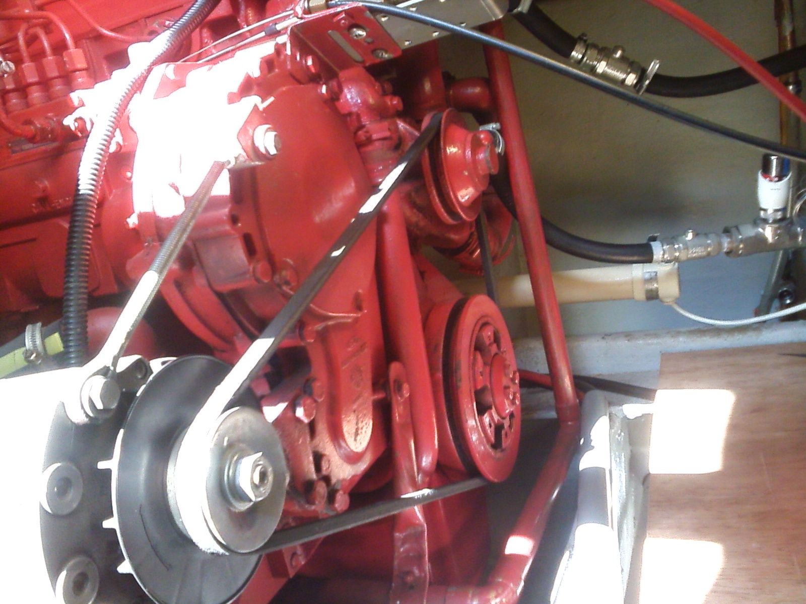

Mine are 6 foot long grey plastic tubes, about 4" in diameter with a 230v cable coming out of the end.
I have one each side of the engine room.
Can just be seen on these pics (on outboard side of each engine) & on the RH side of each picture - one with 'orange lead, and one with a white lead.
Edited by Alan de Enfield
