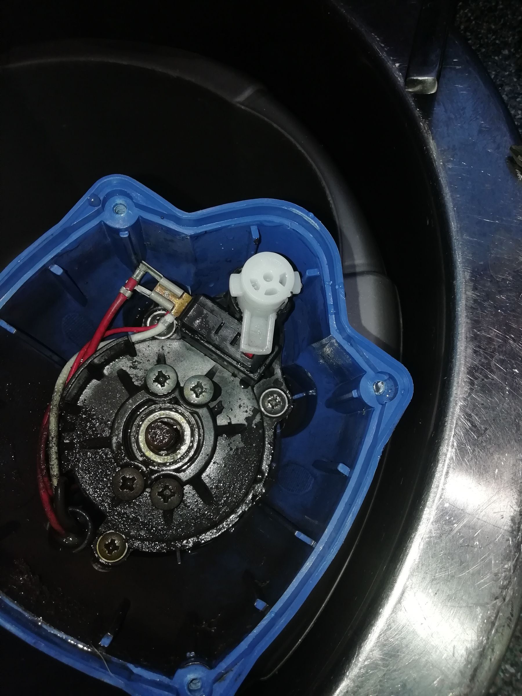

So I unbolt the end just for a look inside and it shouldnt have even been working. The whole body was pressurised and the motor and everyithing behind the pump that should be dry was completely full of water including all the lectrical connections. The black hard pumpy thingy bit was starting to break up. So all in all we got our moneys worth out of it.
I bet that felt satisfying finding that.
:D Absoblooominlootely. God only knows why it was still working at all!! The bad news is that I had used my spare on mi motorhome and should know better, this is why I always carry spares but as I have a mooring at present I got complacent. I had to nip down to Heyford and pay 20 quid more than getting one delivered, I wasnt waiting around till tomoz or the day after for 20 quid but I am peeved with myself. I have ordered one to be delivered today though as a spare :unsure:
Looks like the remains of a mouse to me.
