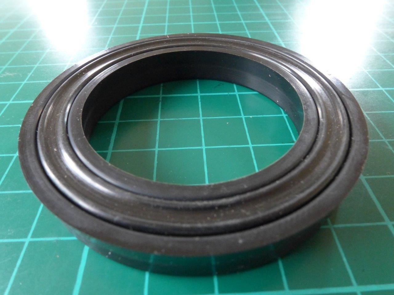

Hydraulic seals are generally polyurethane.....I would suggest you change to a material which can use water as a lubricant........natural rubber is one,and I have no doubt a seal specialist could recommend others more modern.....Although some seals using teflon sinters and the like are kinda spendy.
Thanks, that’s very helpful to know.
I guess it ties in with the advise from the respected Kelvin engineer who did the work a few years ago, to squirt a little oil around the piston before each use. I have done that, but as the leak rate increased, I would think it got flushed out rather quickly.
I’ll do some detective work.
I would guess the solution lies in a teflon filled polymer seal,as the teflon deposits on the metal surface and provides a run dry lubrication........For an economical teflon seal,Ive found the ones made of thin (002/003) teflon sheet cut into "washers" and stacked into a seal the required thickness.Needs to be clamped in the housing tho,something like a gland nut,but not further adjustable after being set tight.

Hardchrome is a good surface for a seal,your problem is probably the seal starting dry ,then running wet.......Natural rubber likes water as a lubricant, even one dry stroke will tear it, oil will ruin it........this is why some suitable polymer is needed,to provide that initial lubrication when dry....Another idea might be MoS2 filled plastic,but I would look at the thin sheet idea..........I fitted these to piston valves used to controll the flow of yucky stuff in a dog food factory.......the liquid was very corrosive and erosive,and despite the hard stainless of the valve failing,the seal stack was still working without leakage,or apparent wear...........Another idea is to modify the gland to include a lubricant sump,use UHMWPE as a seal,and silicone seal lube from Graco .A I litre bottle should last years.
I also see that your hydraulic seal has a quad ring packing in the section......this is to provide sufficient force to seal oil at pressure.......this is contributing to the wear.......the ring should just come out of the seal,its normally a loose piece,with maybe a dab of sticky to keep it in.

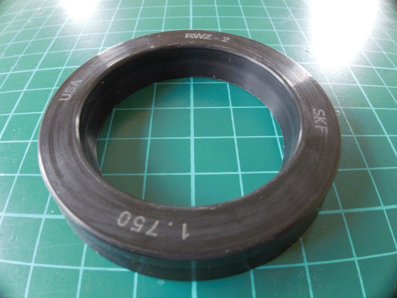

My spare seals are on the boat - I’ll take a closer look at them on my next visit, perhaps next week.

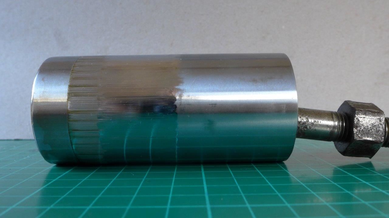

Update:
By following BEngo’s advice carefully, the dismantling was straight forward once the ram was persuaded downwards a few more mm by reappropriating my bamboo fuel measuring stick?

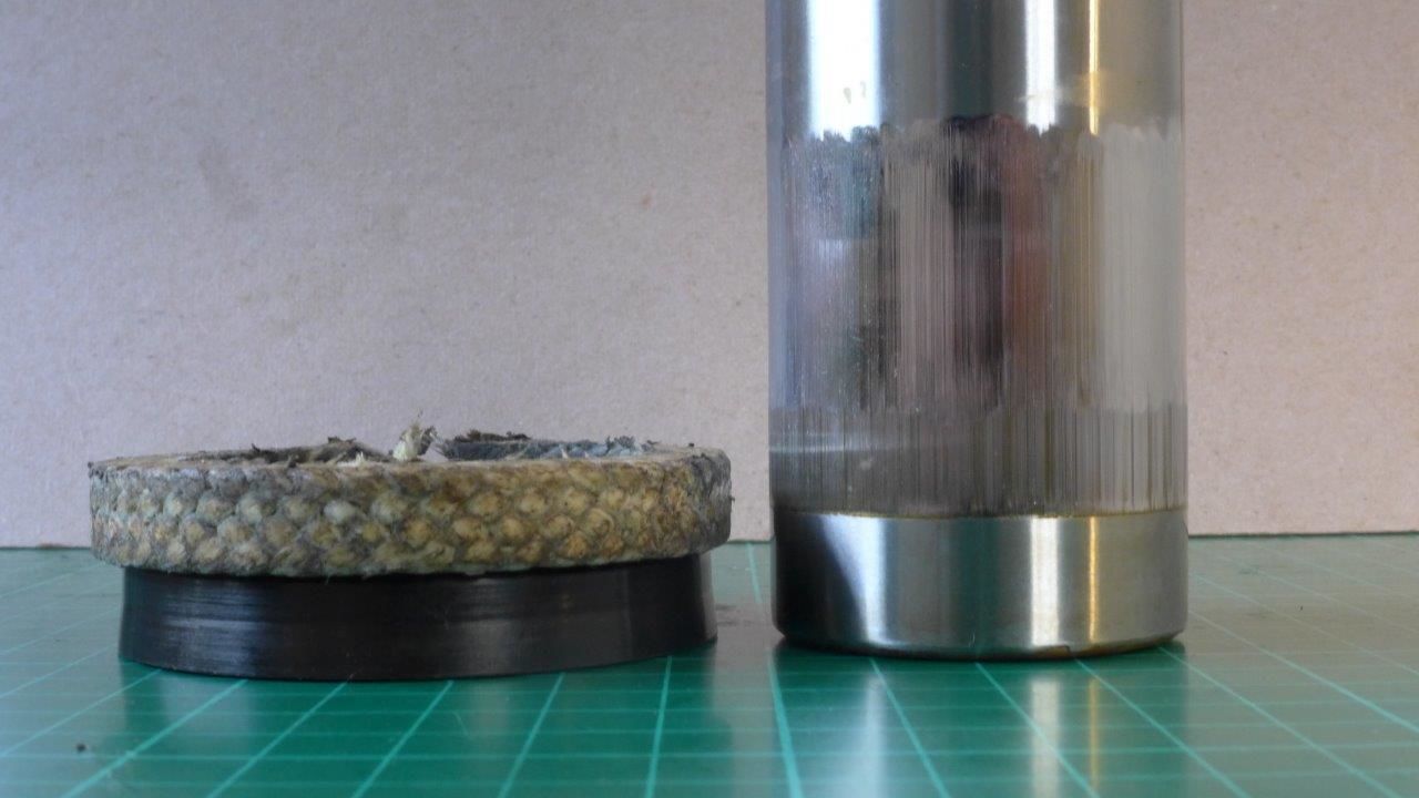

It turned out that the hyd seal has been supplemented by a single ring of packing above it.

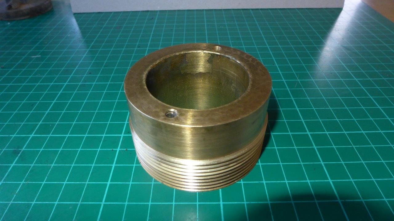

As previously mentioned, a mod prior to my ownership has restricted the number of rings of packing that can be fitted whilst still leaving enough thread for the gland to engage with the pump body.

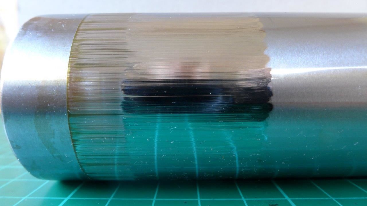

Visually, there seems to be significant wear to the chromed ram, with two distinct areas seen.

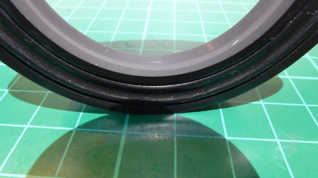

The coarser lower 1/3 being swept by just by the lower lip of the hyd seal and the more polished upper 2/3 swept by ether both seals or just the packing.
Surprisingly, the deepest measurable wear depth is just below the top line at about 0.1mm (0.2 off the diameter) compared to the nominal 44mm diameter just above this line.
The wear is somewhat less in the lowest segments, so it seems that the lip of the hyd seal has caused the most scratching and the packing has caused the highest wear. Of course, this ignores the depth of the scratches and lateral forces from the pump rod.
Three slight ridges can be felt; however the wear has not exceeded the thickness of the chrome plating.
If necessary, I’m now happy to service the pump each year, so I’m considering ditching the hyd. seal and reverting to the previous option of two packing rings.
I’d be grateful for any suggestions or observations; however I would prefer to avoid an alternative type of pump.
Thanks.
Edited by gbclive
Theoretically at lest you should be able to use an O-ring seal  but that would mean a different follower.  Practically, I did try one,  with good results for about 12 months, but once it failed it was pissing out water, where a packed item fails gracefully.
Two woven packing rings is all there now is in mine.  Forget exactly what, but I bought a 50 m box from Walkers and expect it to see me out! Last time I changed it was ages ago.
If you wanted space for another ring of packing you would need to modify the pump, not the follower.  Not something I would contemplate.
Might be worth considering a grease nipple on the follower with an outlet hole positioned to lubricate the packing? Bet the nipple would end up where grease gun access was impossible.  I would also worry about grease getting in the coolant.

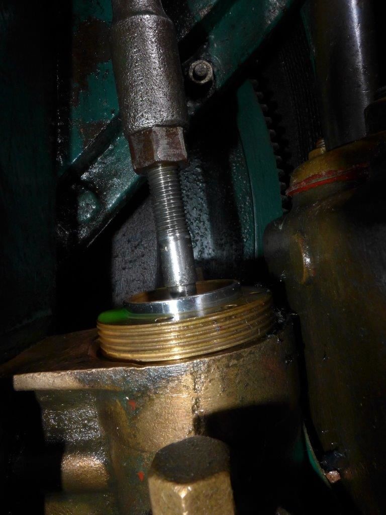

Update:
Other jobs on the coolant system now complete, so today I topped up and bled the engine coolant, then turned the engine over by hand to see the initial result of reverting to two rings of conventional packing after the experiment of using a composite seal made of a hydraulic seal + a single ring of conventional packing. (No room for 3 rings due to an earlier modification).
So far no weep between the ram and the gland, but a slight weep up the thread between the gland and the body.
Would it be beneficial to use something like Boss White Pipe Jointing Compound on the bronze thread?
Thanks.
Boss white should seal the follower  thread, but will make it hard to adjust and a bugger to get out.  I would use a good dollop of K99 stern tube grease instead.
There should be  slight seepage betwixt ram and packing  for lubrication and cooling.  Some will probably appear once it has warmed up and bedded the packing in.  Then you can adjust things.
N
Thanks - that makes sense.
I might have over tightened it as it’s as tight as I could comfortably do it using two steel pins.
This was to try and stop the thread from weeping, rather than the ram, so I’ll back it of a tad, then adjust after its bedded in.
Thanks.
