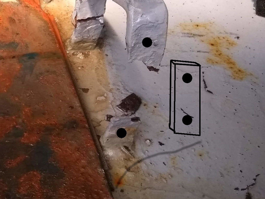

I have an ex-Black Prince probuild narrowboat which has the weed hatch apparently through the fuel tank. The hatch is secured by a bar across two steel loops welded to the tank.
One of these loops has failed ( maybe my fault over tightening weed hatch - appears to be ductile failure of one loop, see picture ). It seems to me that I will need a new loop welded in, but this is on top of the diesel tank.
I believe the diesel tank is integral with the boats structure - so does this mean the diesel tank need to be drained first and inerted before welding ? Does it then require pressure testing again ?
Any advice on practice here ?

Sadly the loops are on the tank. I should perhaps have added a photo from further back which shows the tank more clearly.

Doesn’t have to be welded. Fix a new one on using big rivnuts.

Would it be possible to hammer the loop back into place and then make a new loop which fits over the existing one. Then drill and bolt the new one and the old one together through the upright sections?

There is a stub of the clamp loop still attached to the tank top. Is there enough metal there to drill a hole and another in the other side of the break and bolt/rivet a strap across? Might need taping, iether in to the loop, or strap, rather than nut/bolting if there is a clearance issue with the clamp bar. Countersunk bolt head could also help with clearance.
Jen
See pic below:

I would have thought the best way was remove old bracket, make new one, drill, tap and bolt this in position, using sealant to complete the repair.
1 minute ago, LEO said:
Hi,
This loops us back to my suggestion to do this but using Rivnuts in Post 5. I suggested this because we don't know the thickness of the top of the diesel tank. Quite possibly only 3mm.

I think rivnuts or drilling and tapping is the way to repair this and welding being the last resort,and then only done by a qualified person with proper equipment,inert gas.fire fighting gear etc.
Take the boat to any good boatyard with an experienced welder and they will weld it for you. If you are worried you could fill the top of the tank with inert gas, but the boatyard welder would not bother to do this.
