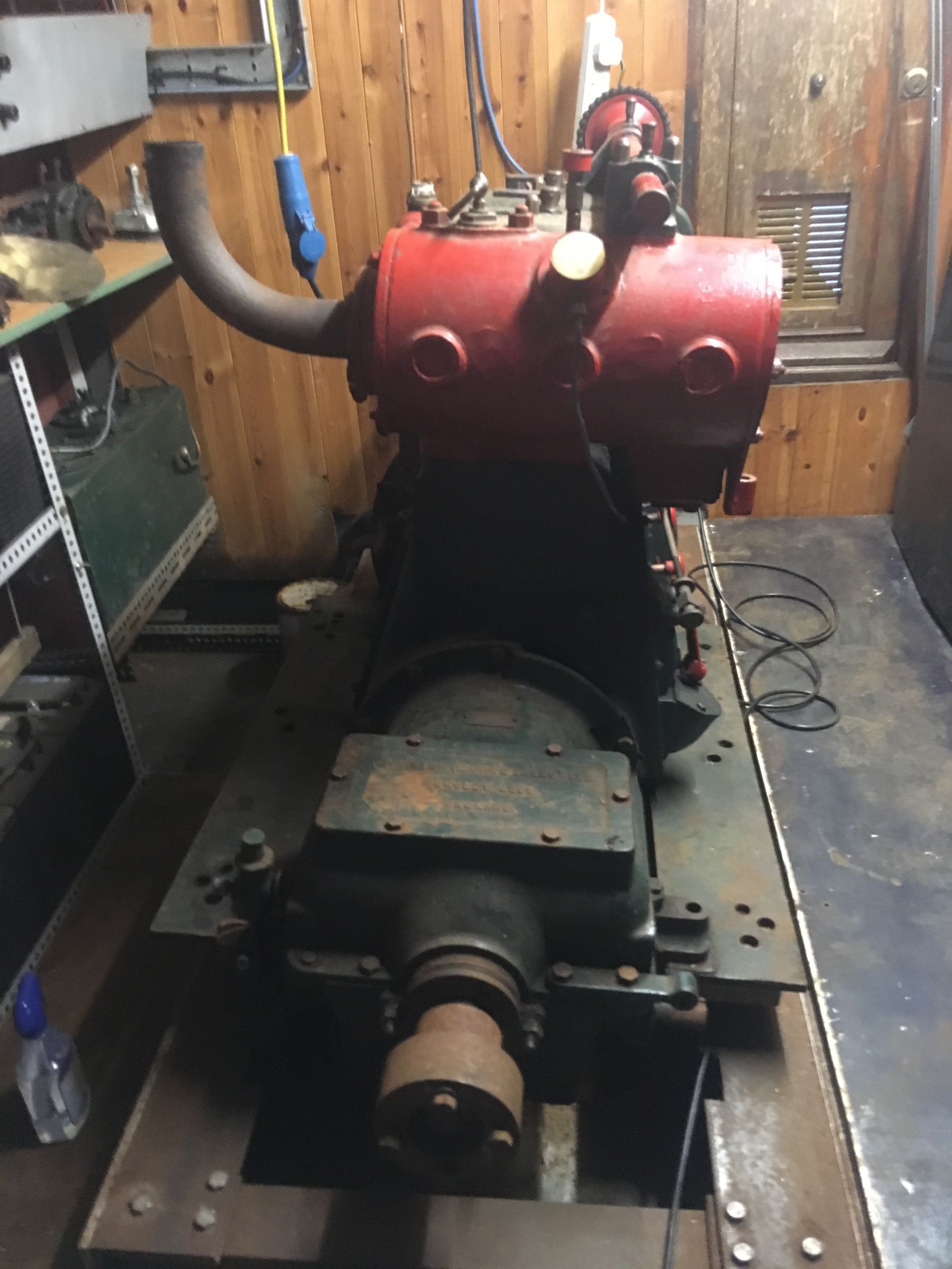

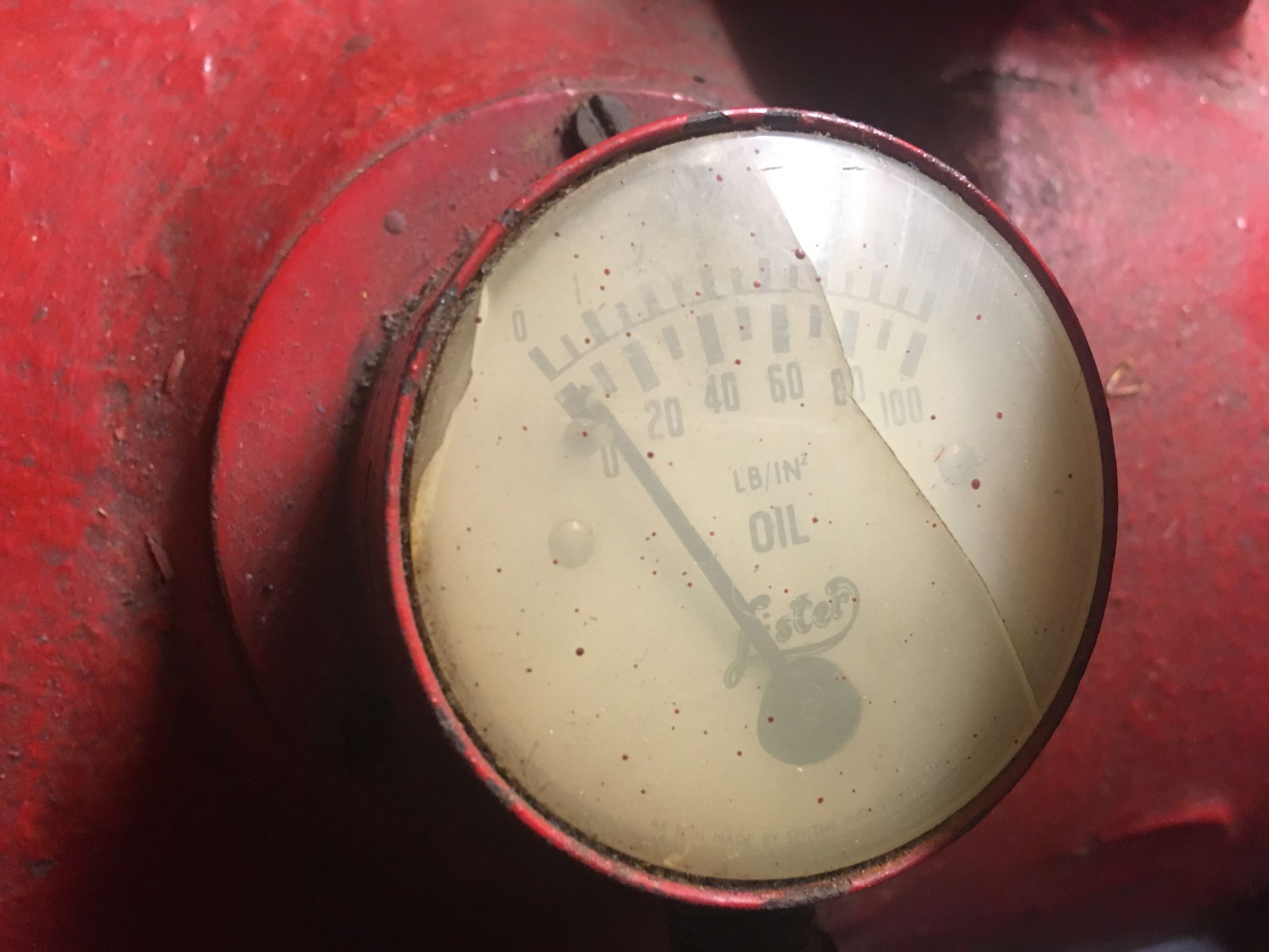

MANNCANALBOATPAINTERS Posted April 13, 2019 Report Posted April 13, 2019 (edited) I’ve just purchased a Narrowboat, the previous owner has started to install a lister jp2 before he sadly passed away, it’s not very suitable for this boat , and I’m looking to sell the boat yard where I’m at said it’s been running not sure of history. https://ibb.co Edited April 13, 2019 by MANNCANALBOATPAINTERS

MtB Posted April 13, 2019 Report Posted April 13, 2019 6 hours ago, MANNCANALBOATPAINTERS said: I’ve just purchased a Narrowboat, the previous owner has started to install a lister jp2 before he sadly passed away, it’s not very suitable for this boat How can a JP2 be anything other than imminently suitable for a narrow boat?!!! Granted the chap has put it in the wrong place, but even so...

BWM Posted April 13, 2019 Report Posted April 13, 2019 Those standard type engine mounts beside were wishful thinking!

martyn 1 Posted May 7, 2019 Report Posted May 7, 2019 JP2M in non running condition no more than £3k tops and idustrial around the £1.5k mark tops. Having personally seen enough "runners" even if it did run I would be wary without a autopsy on it before fitting it to a boat. I have had alot come through the workshop that start and run but are w"£ked when stripped down. And to do a rebuild on one properly they are not cheap. A few things can be checked on one that is not dismantled to give a hint of if its ok or not. amount of compression, endfloat on crank and lift on crank. the later two are normally a good indication of if it will need work.
RLWP Posted May 7, 2019 Report Posted May 7, 2019 4 minutes ago, martyn 1 said: JP2M in non running condition no more than £3k tops and idustrial around the £1.5k mark tops. Having personally seen enough "runners" even if it did run I would be wary without a autopsy on it before fitting it to a boat. I have had alot come through the workshop that start and run but are w"£ked when stripped down. And to do a rebuild on one properly they are not cheap. A few things can be checked on one that is not dismantled to give a hint of if its ok or not. amount of compression, endfloat on crank and lift on crank. the later two are normally a good indication of if it will need work. It takes a lot to stop an old Lister running Richard
MtB Posted May 7, 2019 Report Posted May 7, 2019 2 minutes ago, RLWP said: It takes a lot to stop an old Lister running Richard Water in the fuel can be very effective... 1
martyn 1 Posted May 7, 2019 Report Posted May 7, 2019 1 minute ago, RLWP said: It takes a lot to stop an old Lister running Richard Very true, but with a JP2 not having a centre main bearing, if they have worn out bearings then a snapped crank finishes them off pretty quickly and unfortunatly its more common than you might think. 95% of the time it can also be put down to knackered bearings, so had the wear been dealt with when needed it wouldn't of been an issue, regrind, bearings and good for another 50 odd years.. 1
MtB Posted May 7, 2019 Report Posted May 7, 2019 13 minutes ago, martyn 1 said: Very true, but with a JP2 not having a centre main bearing, if they have worn out bearings then a snapped crank finishes them off pretty quickly and unfortunatly its more common than you might think. 95% of the time it can also be put down to knackered bearings, so had the wear been dealt with when needed it wouldn't of been an issue, regrind, bearings and good for another 50 odd years.. Martyn, is there any way an ordinary boater like me would know if theIr JP2 had knackered bearings that needed to be ‘dealt with’ as you put it? Many thanks...
cuthound Posted May 7, 2019 Report Posted May 7, 2019 35 minutes ago, Mike the Boilerman said: Martyn, is there any way an ordinary boater like me would know if theIr JP2 had knackered bearings that needed to be ‘dealt with’ as you put it? Many thanks... Yeah, the crank will be broken... ?
MtB Posted May 7, 2019 Report Posted May 7, 2019 Just now, cuthound said: Yeah, the crank will be broken... ? So peeps should get their JP2 main bearings reground just before the crank breaks? This seems a good policy. Thanks! 1
RLWP Posted May 7, 2019 Report Posted May 7, 2019 1 minute ago, Mike the Boilerman said: So peeps should get their JP2 main bearings reground just before the crank breaks? This seems a good policy. Thanks! Oil pressure is usually a good start 1
steamraiser2 Posted May 7, 2019 Report Posted May 7, 2019 1 hour ago, Mike the Boilerman said: Martyn, is there any way an ordinary boater like me would know if theIr JP2 had knackered bearings that needed to be ‘dealt with’ as you put it? Many thanks... As Martyn said, end float and detectable lift on the crankshaft. Any end float above a few thou is generally a pretty good indicator of a developing problem. 2

martyn 1 Posted May 8, 2019 Report Posted May 8, 2019 15 hours ago, RLWP said: Oil pressure is usually a good start You would think so, but as a JP oil pump is sized for the largest in the range when were talking about the smallest then the pump has alot more capacity than the engine needs. It can maintain half reasonable oil pressure (if you can call 15-20psi reasonable..) on a JP2 long after your in the realms that the main bearing wear is well outside Lister's tolerances and well into the realms of snappy snappy crank. But as I said earlier with a big prybar and a clock gauge you can normally very quickly tell if this is the case in situ and in one piece. 1
