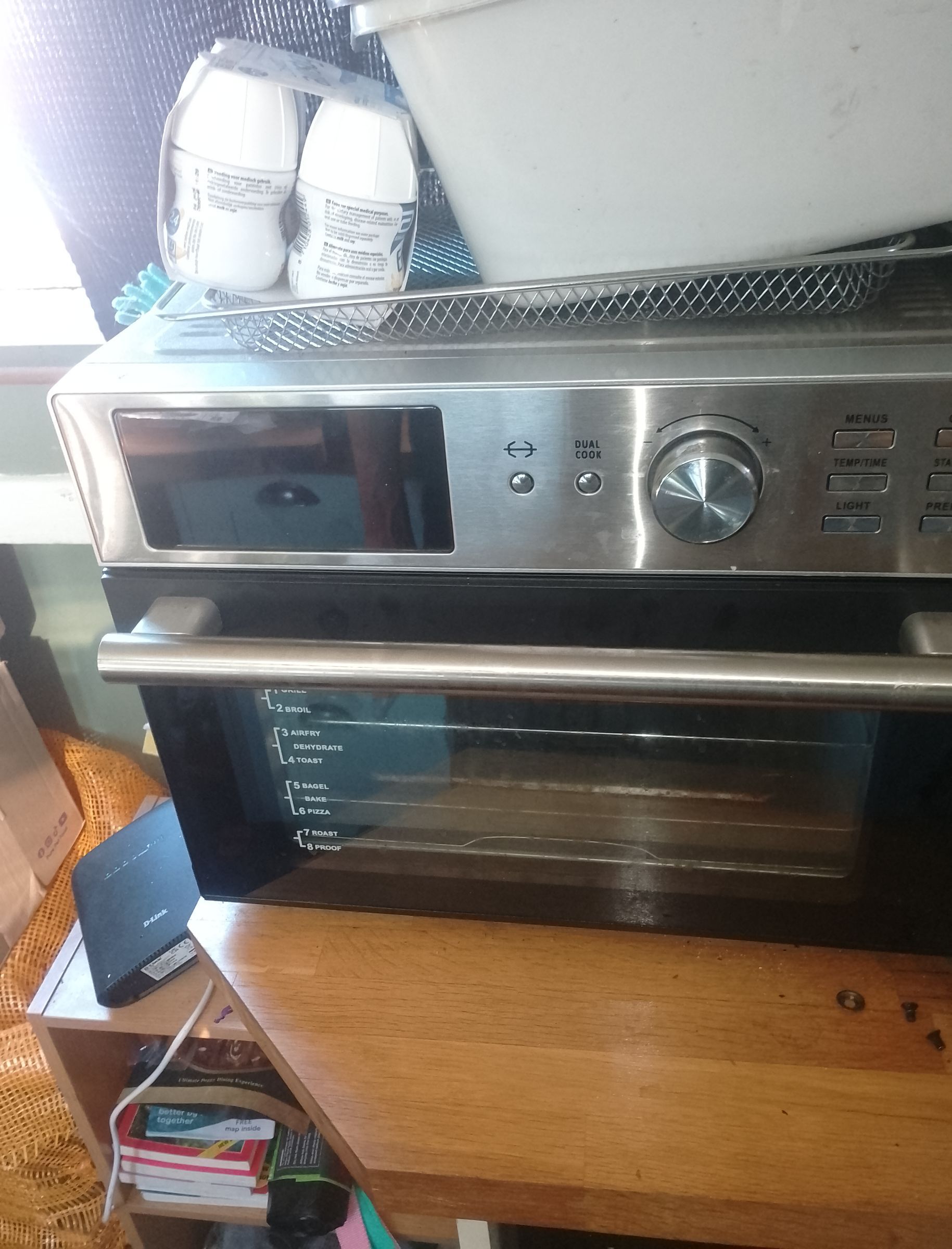

  13. Well I have two 300ah lithium batteries and I am having to turn off the charger every day, to stop the batteries going above 95%, I know they turn themselves off but that is at full charge, keeping the charge at 95% help battery life. So all that wasted solar could easily heat a 1kw immersion heater and I wouldn't need to turn off the charge unit, so that's what I intend doing after it is fully installed. I all depends on your situation lar panels and how much you can produce, my 54ft boat has a full roof of flexible panels 3 large 400w two 200w and two 175w, I have an industrial air fryer that I use all the time pictured below and it doesn't take enough out of the batteries, a 1kw immersion should be no problem in summer
