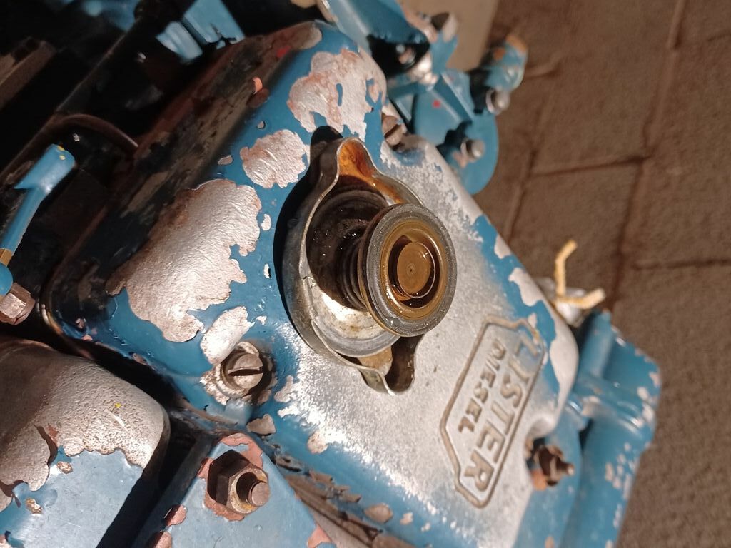

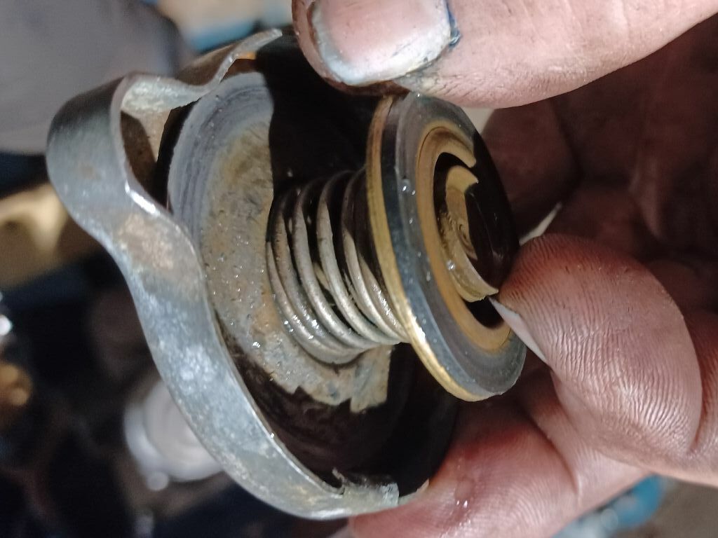

  12. I was expecting to see something like the cap above. The central disk is the anti vacuum valve: Richard
  13. Could you send a picture of the cap side-on? Richard
  14. Oh blimey - I've been keeping up with the other engine problem and skipping this one. I'll have to read back to see what's going on Thanks Tony Richard Have you come across the folklore engineering solution of removing the thremostat applied to an Alpha? First off, no water will come out of the outlet pipes (there you go mate, your pumps knackered) Secondly, the engine boils really quickly. Richard THIS^^^ I can't see the anti-vacuum part of that cap. Without one it won't draw coolant back On our BMC, I always leave an air space in the manifold tank Richard
