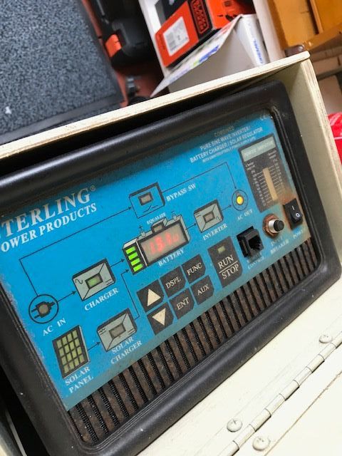

  8. 4 hours ago, MichaelG said:
    Hi all, I have the pictured Sterling inverter charger, probably about 15 years old as I think it was fitted to the boat from new. It has a power saving function which keeps the inverter in a standby mode until a demand is detected. The problem is it now seems to be having a problem detecting when there is demand, particularly from small draw devices. I believe that it is possible to deselect the power saving function? Just wondering if anyone has or has had this type and knows how to do it. I am currently working around the problem by switching on a 230v lamp which brings the inverter out of standby mode so that I can then use the device I actually want. Thanks in advance for any advice.
