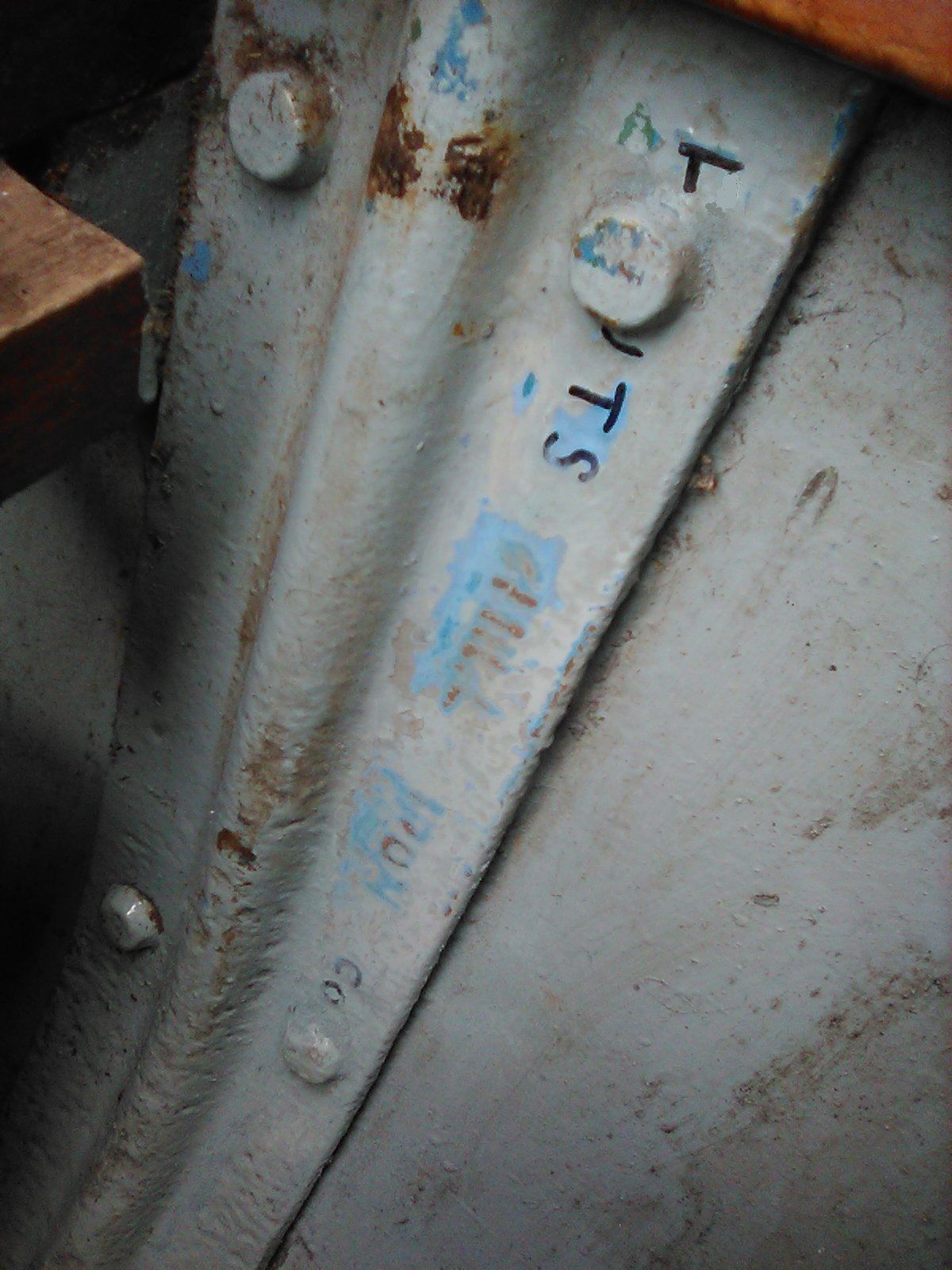

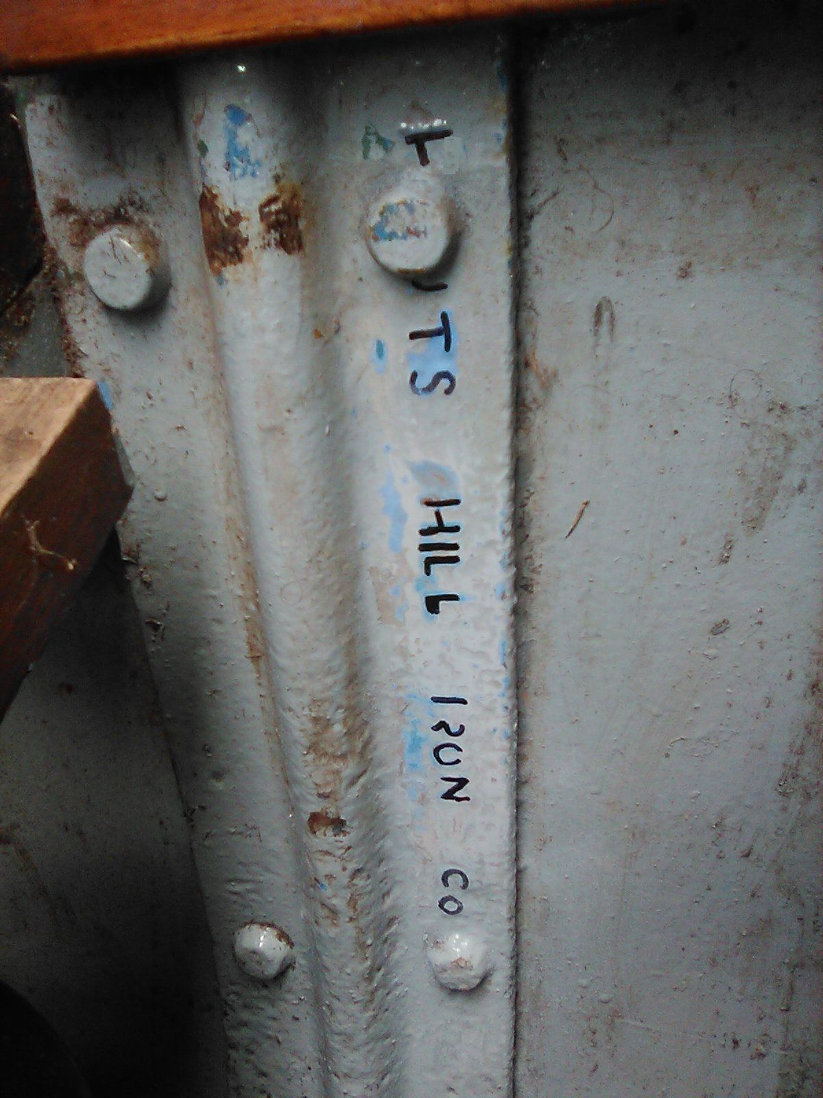

  5. I had a go today at deciphering the faintest suggestion of a foundry marking on one of Sara's frames yesterday. The original lettering does not seem to have been particularly bold and several thick coats of paint had made all but the TS fairly indistinct. After a bit of wet n dry I had the following results: I'm not so sure about the characters either side of the rivet, but TS HILL IRON Co looks fairly convincing to me. Poping that string into google brings up HARTS HILL IRON Co. of Dudley, established in 1846, which agrees with an assumed 1850's date for the hull. This raises the question of whether they simply supplied the raw stock for someone else to make the hull, or did they build it themselves under contract? Interestingly they appear to have built other boats - BHP No.2 still being extant (Edit: unless this is a modern attribution due to being displayed in Dudley close to the iron works site?). The overlaping plates on Sara's bow and stern are very much in the style of black country day boats.

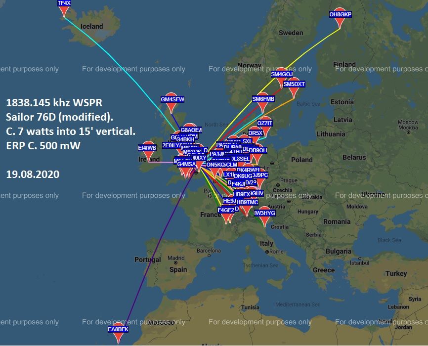

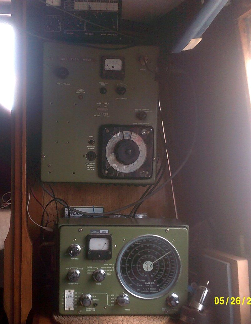

  9. We were heard in Iceland the other day - does that count? The Off switch is top left. It is the only control the wife knows how to operate ? Caroline are now licenced to use the former World Service facility at Orfordness, 1 KW on 648 khz into a 350 foot mast. I do find it amusing that the former pirate is using an ex-BBC facility that was paid for by the foreign office... An overnight transmitting session on the Sailor 76D installed on Sara:
  10. I think the sailor series of radios must be some of the best general purpose receivers ever made. We have a 66T in daily use here on Sara, usually tuned to either Radio 4 on LW or Caroline on 648. It also sees use on the amateur bands with the companion 76D transmitter. Tuning coastgaurd broadcasts is a little fiddly and requires safe cracker fingertips!

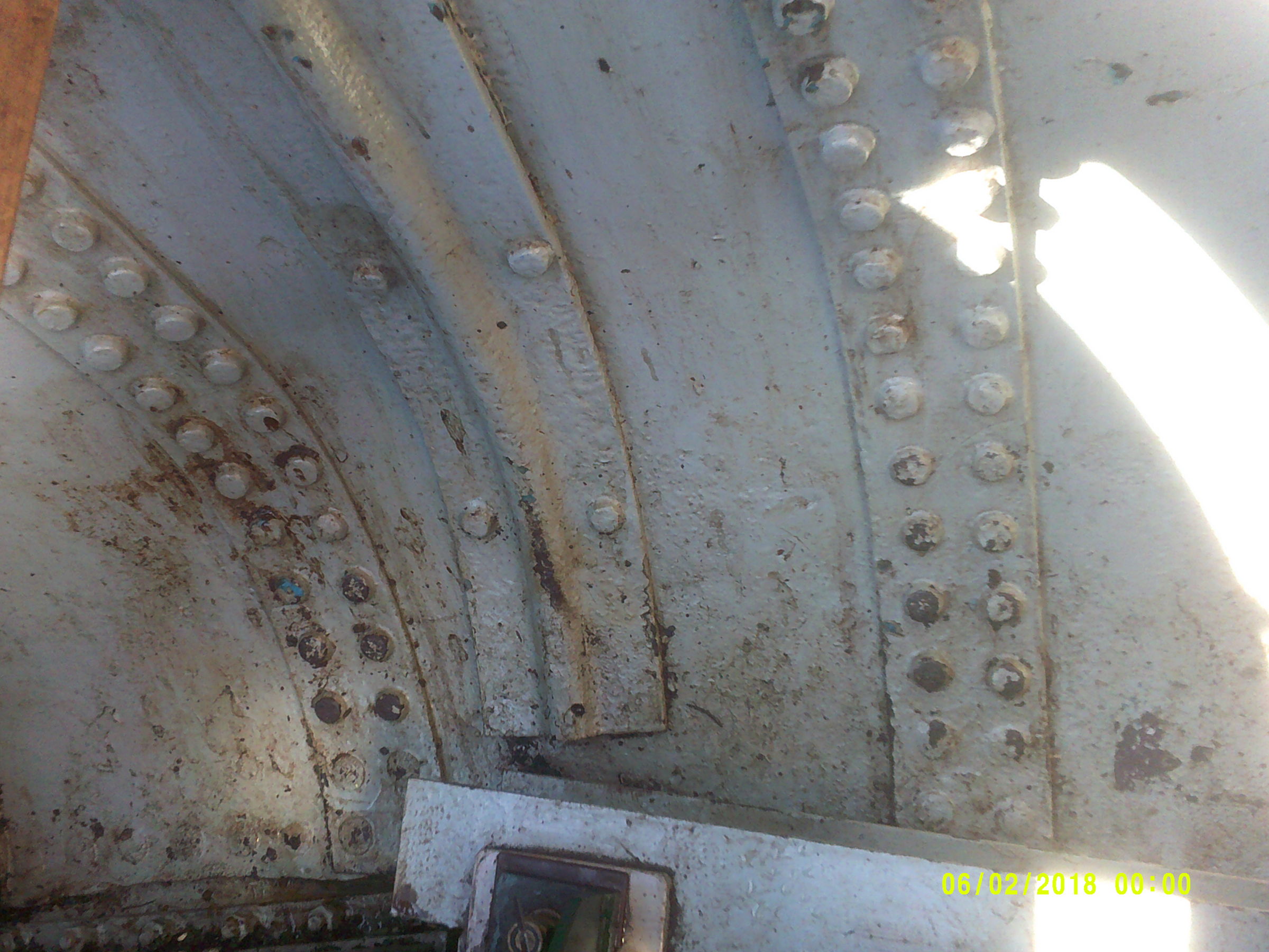

  13. Hello everyone, I spent a lot of time squeezed and contorted into various small spaces below decks yesterday whilst I tightened our stern gland and sponged out a quantity of greasy water from the bilge. I spent some time examining Sara's construction and it occurred to me that her frames are not as thoroughly fixed as the doubling straps where adjacent hull sheets are abutted and riveted together. You can see a frame in the image below with two such straps either side, this area being in the curved butty style stern. I always assumed that the frames would have been used to form the curve of the hull first with the hull plates applied over them (as in conventional ship building), but in places the frames do not conform too closely to the hull - at their lowermost ends I can usually get a finger between them and the baseplate. Looking closely and the image of the bare hull it is clear that none of the frames form a continuous a piece - they are more akin to an elongated knee as might be found in a conventional work boat. The hull plates are sandwiched between these extended areas and the base plate, showing that they were already in place before the frames were secured. I take it then that Sara was first laid down as the base plate (in four sections) with the one piece stem and stern, then the hull plating was rolled and riveted into place. The substantial frames then went into the hull, most (but not all) attached to both the hull sides and baseplate. It seems a backwards way to do things and there must have been a reason for it, but I can't see it. is this the way a conventional work boat would have been built? Are the frames purely intended to limit the spreading of the hull in the event that any loads were carried? Or are they to maintain hull shape when riding up onto (and plunging through) ice? They don't seem to have much to do with re-enforcement as there are none in the bow where the brunt of the ice breaking loads would have been borne. I think I'll crack open another can on this fine evening whilst I ponder things... Robert

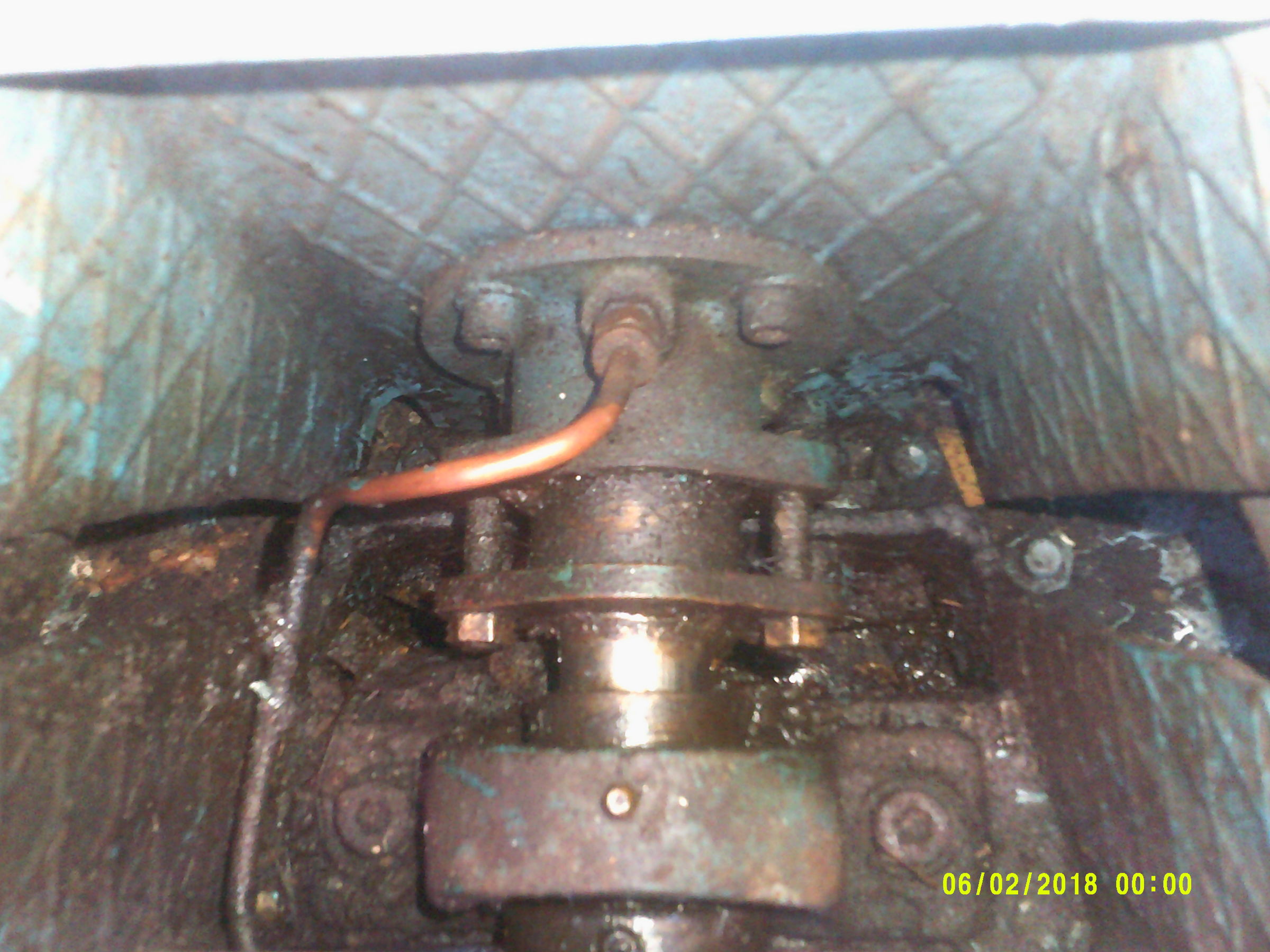

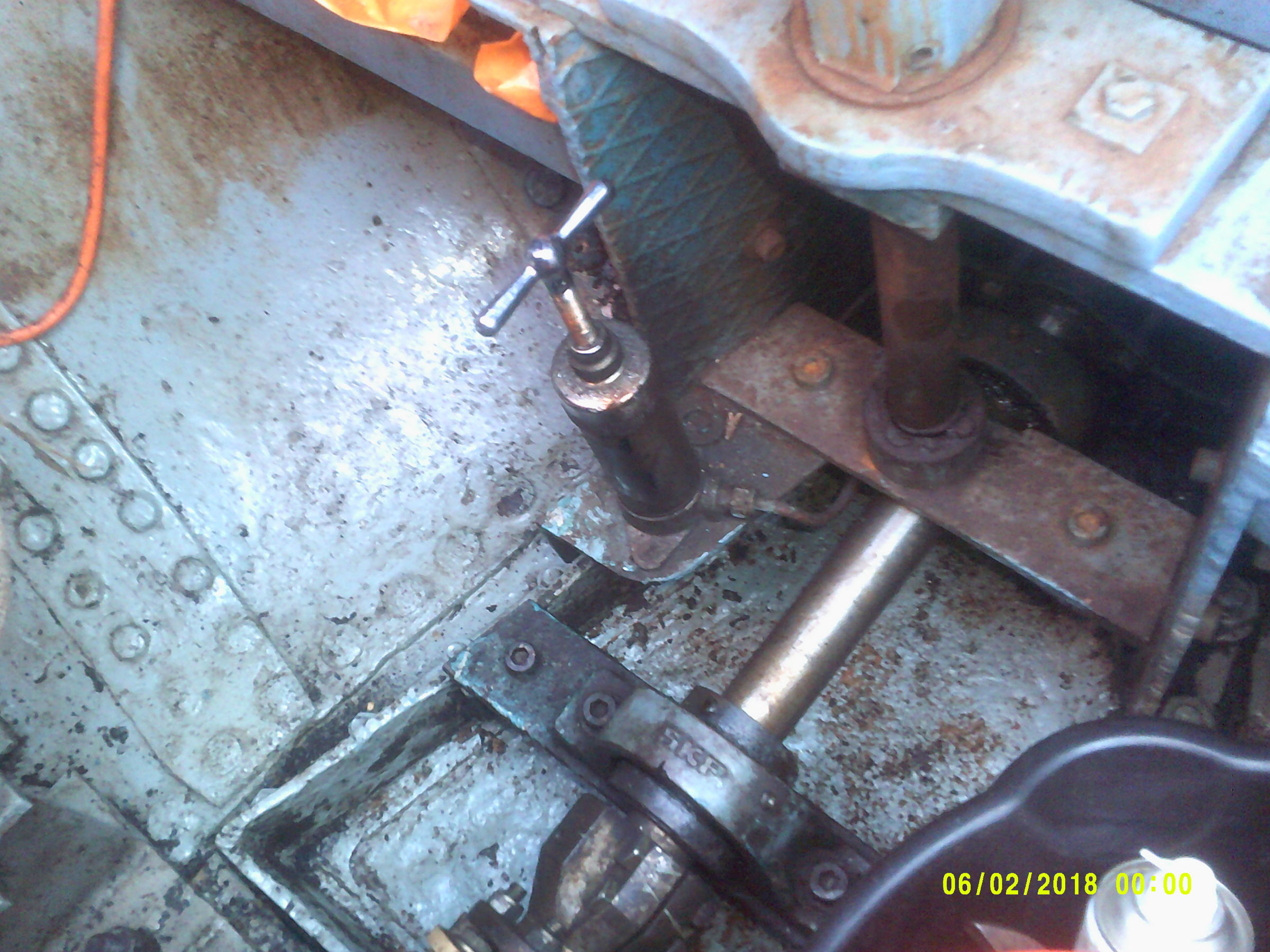

  14. Your water may also come in from the stern gland - the point where your propeller shaft exits the hull - if it is worn. Usually this consists of a flat metal plate with a set of bolts that can be used to tighten up any slack. I had to tighten ours yesterday to sort out a slow but persistent drip. I've attached a picture of ours and the greaser tap that lubricates it - putting in a couple of turns of grease may help if this is your issue. In your picture it will be attached to the end of the black tube exiting the top of your stern gland. Our engine is also an air-cooled Lister and your layout is very similar.
