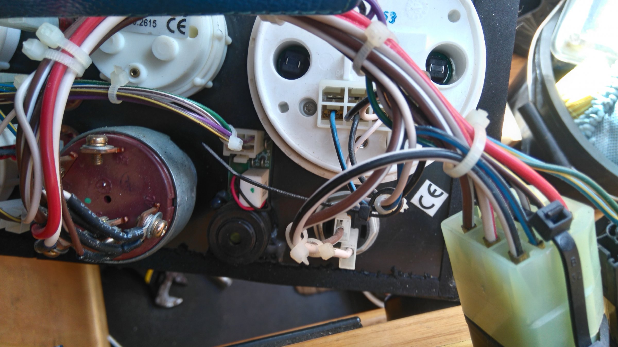

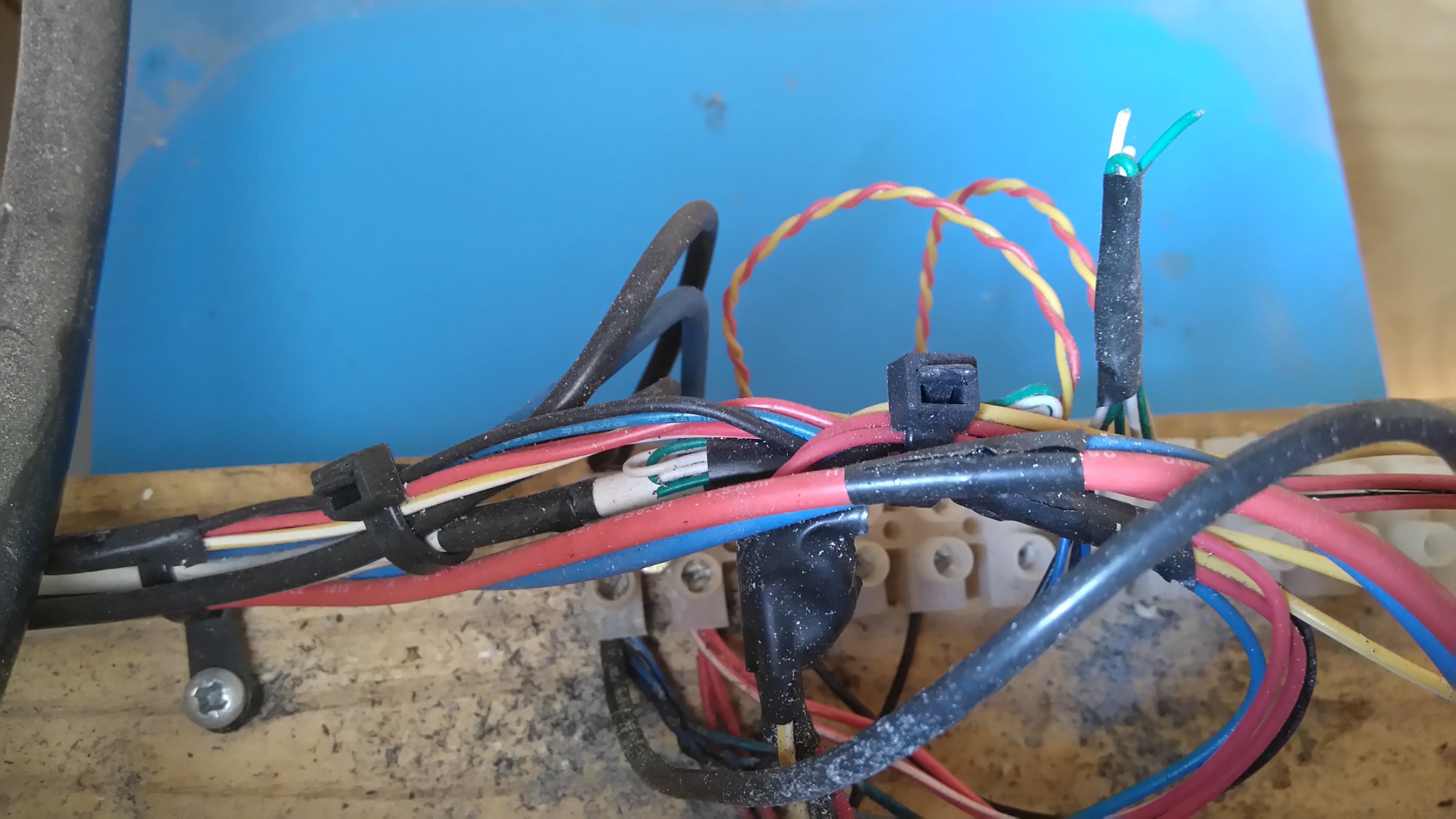

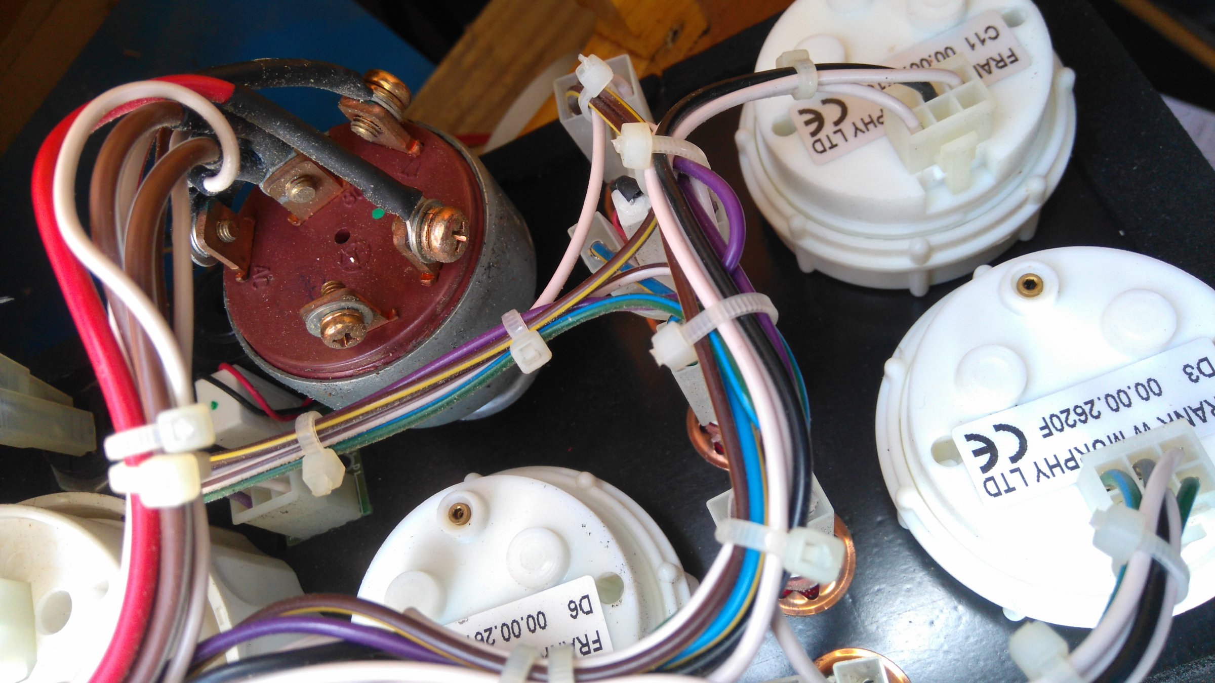

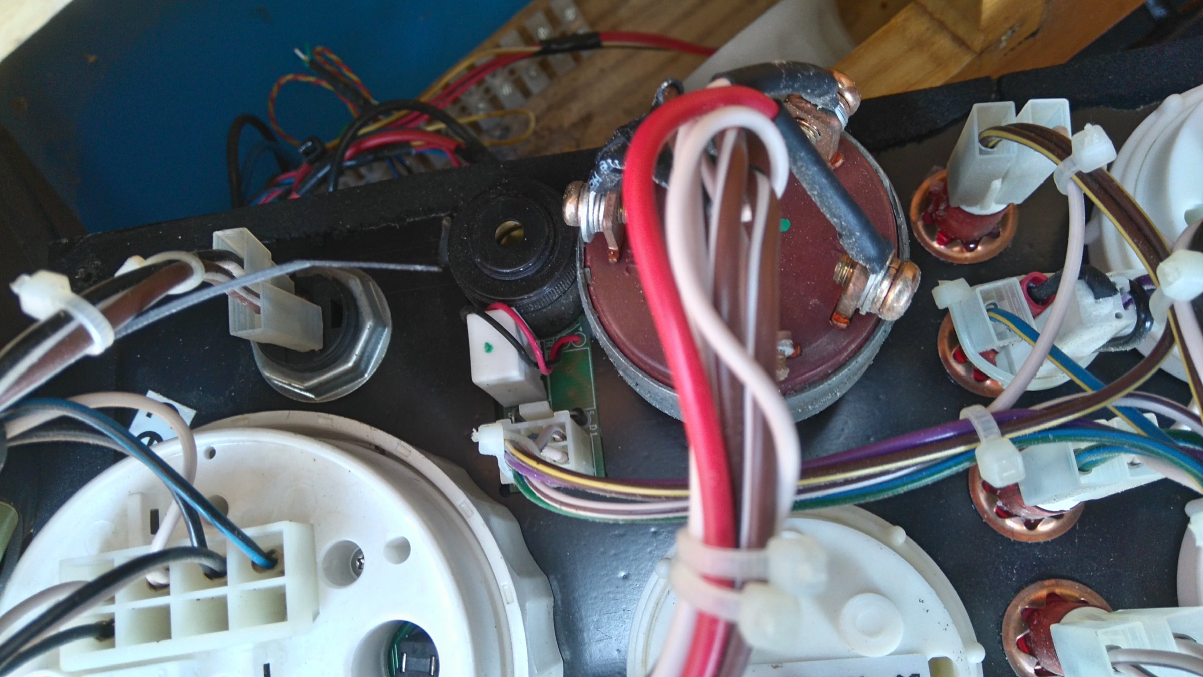

  13. I appreciate that but I am not on the boat at the moment my son is. I will be back on the boat in August and hopefully heading up to Northampton with all things ship shape and as they were before it was installed in a marina for a year. By front cover do you mean of the Victron? it is scary back there. I did however take pictures of the back of the engine panel to see if I could spot an obvious loose connection there but it all looks fine (to me)

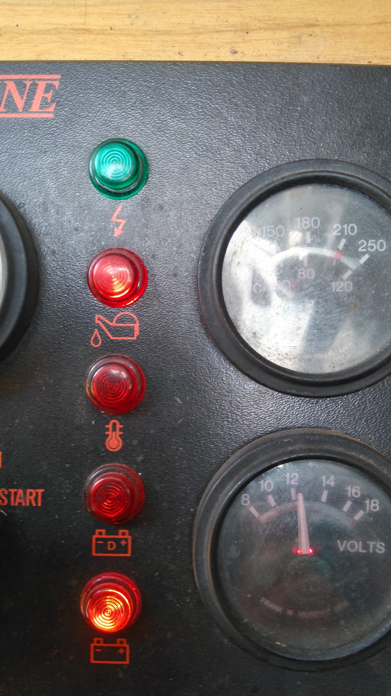

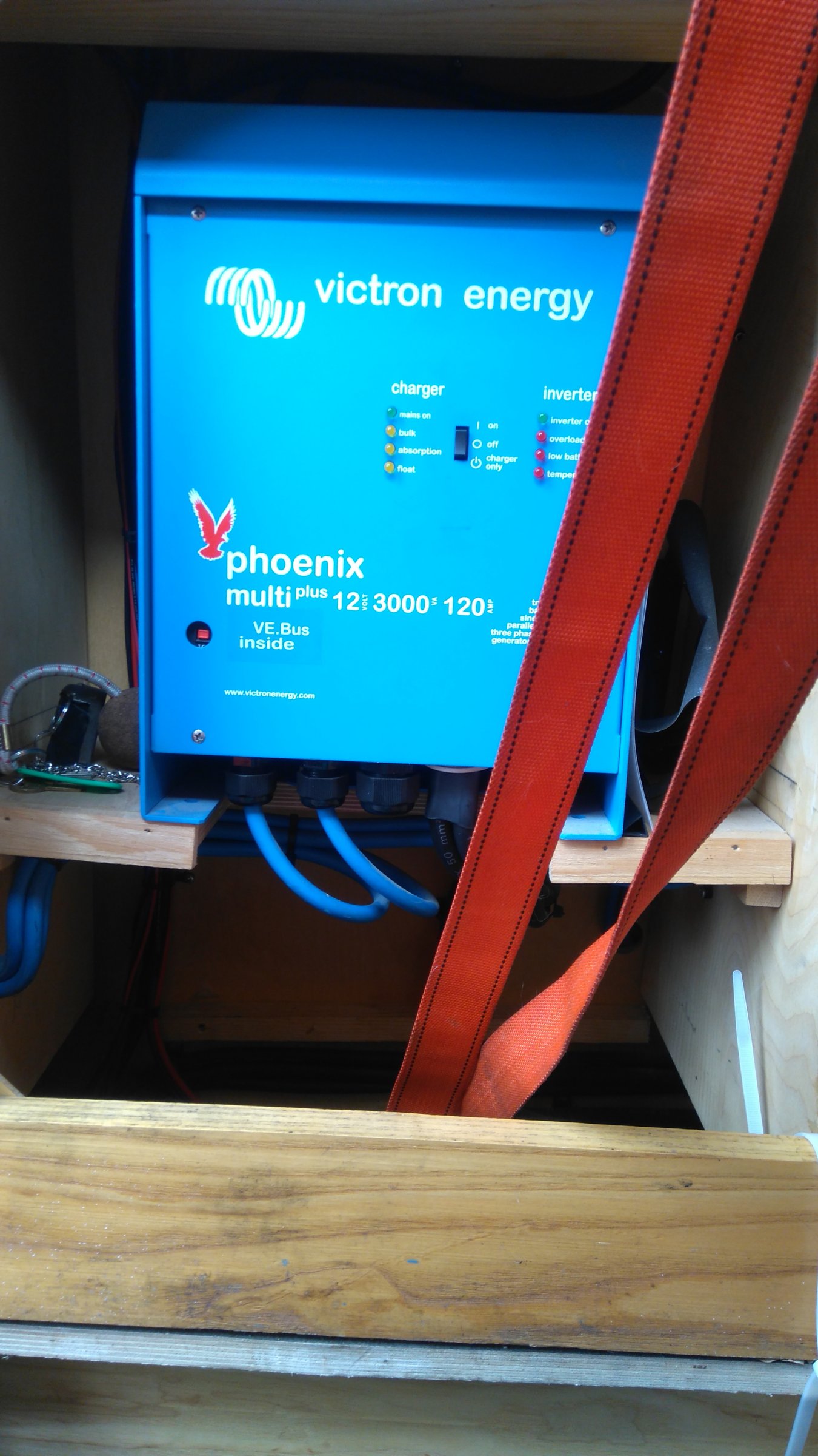

  14. Well I couldn't upload my videos but here are a couple of photos. One of the Victron (ignore the straps these were taking the weight of the new battery as I installed it using my feet to push it onto the swim). Two is the engine panel showing that the domestic light didn't come on and it should. three the engine running showing the domestic light does actually have a slight glow. (I think that is right obviously I took these in April and I have slept since then) shame I can't upload the videos. It would explain such a lot.
