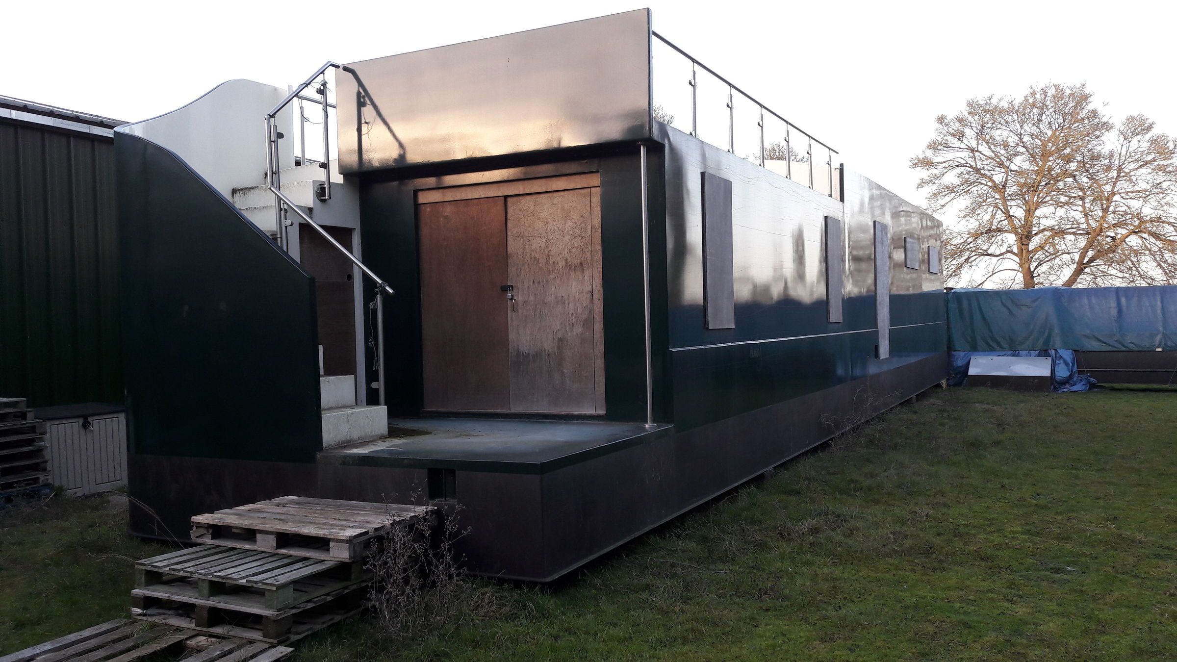

  11. Saw this beauty at Enslow Wharf when visiting friends today. It has redefined my view of fugly.
