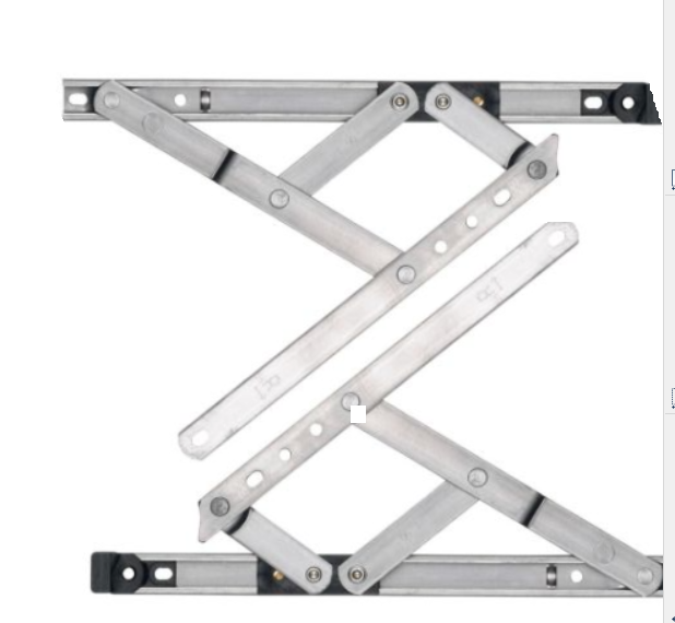

  9. That's a letter N ... I was thinking more like a Z!
  10. Bolt the hinges together like a letter Z, with the hinged movement at each corner. Attach the top to the panel and the bottom to the roof. Then use the bottom hinge to tilt left or the top hinge to tilt right.

  13. If you buy less battery monitors than @Tony1 you'll be able to afford more batteries!
