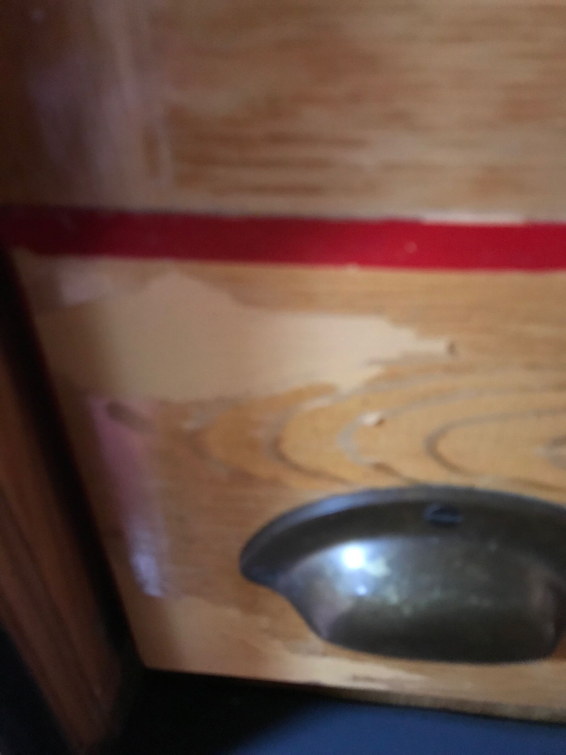

4 hours ago, dave moore said:I suggest that the whole flaking area is flatted down, re undercoated then re grained before applying several coats of a quality varnish such as Craftmaster. Whereabouts are you? I may be able to help with the scumbling if you can prepare the areas. PM me for a phone number if interested.
Dave
Dave, that is an extremely kind offer and one that I will probably take you up on but I insist on paying. I am in Harefield but the weather seems to have changed and in addition I probably need to return to Belfast so it will probably be next year. I have done quite a bit of reading on the subject but I am devoid of any artistic skills.
Parts of the scrumbling on my NB are staring to peel/flake. This is only on the side hatches and rear doors which when open are exposed to the elements. As the boat is nearly twenty years old and the scrumbling in the back cabin is unaffected it’s had a good innings. Where it has flaked there appears to be a cream base coat and the’ flake’ appears to be a form of acrylic or varnish substance. In no way do I have the skills of scrumbling but I would like to touch up the relevant parts or would I be better and waiting till funds allow and get all the doors re done by someone with the appropriate talent? I see one can purchase ‘scrumbling’ paint and I am curious as to what product to purchase. Clearly I would need very little. TIA Martin

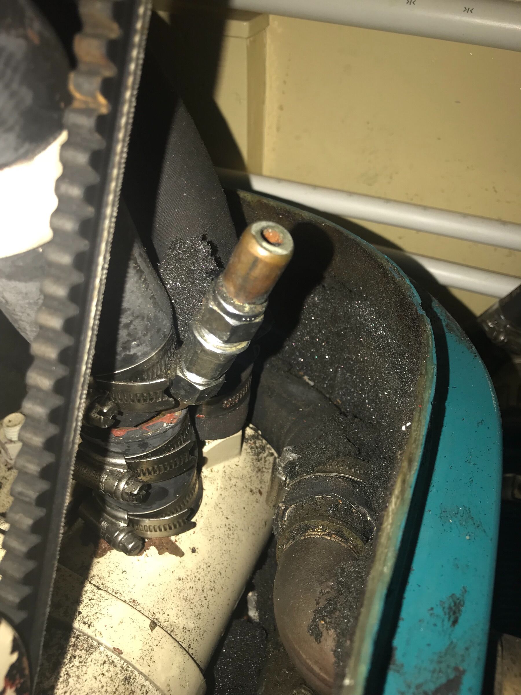

Citric acid, formic acid or oxalic acid are more common descalers.
Phosphoric acid is usually used as a rust remover. After removing the rust, any unconsumed acid goes on eating the steel, until the acid is consumed, so it is normal to use inhibited phosphoric acid for derusting. I am also not sure how Phos acid gets on pros aluminium alloys.
Can you set the genny cooling up so that you could use one of the proprietary engine cooling space cleaners? That would be my preference.

You are obviously quite right about it being used for treating rust but one of the benefits of the acid is that it doesn’t attack the metal, just the rust. I believe it’s also the prime ingredient in ‘Barnacle Buster’ so I’m guessing it doesn’t attack the seals.
After a few years of being unable to do some basic maintenance tasks on the boat due to some physical constraints, at last, I am now in better physical health and itching to get started. Amongst those tasks is to service my in built diesel generator including flushing the raw water system. I was considering introducing some descaler into the system via the raw water strainer and allowing it to sit in the system for a few hours before emptying it. I was going to use phosphoric acid diluted to 45% as the descaler. As most members of this forum are considerably more knowledgeable than me I thought it might be best to run this idea past you before I do😂
