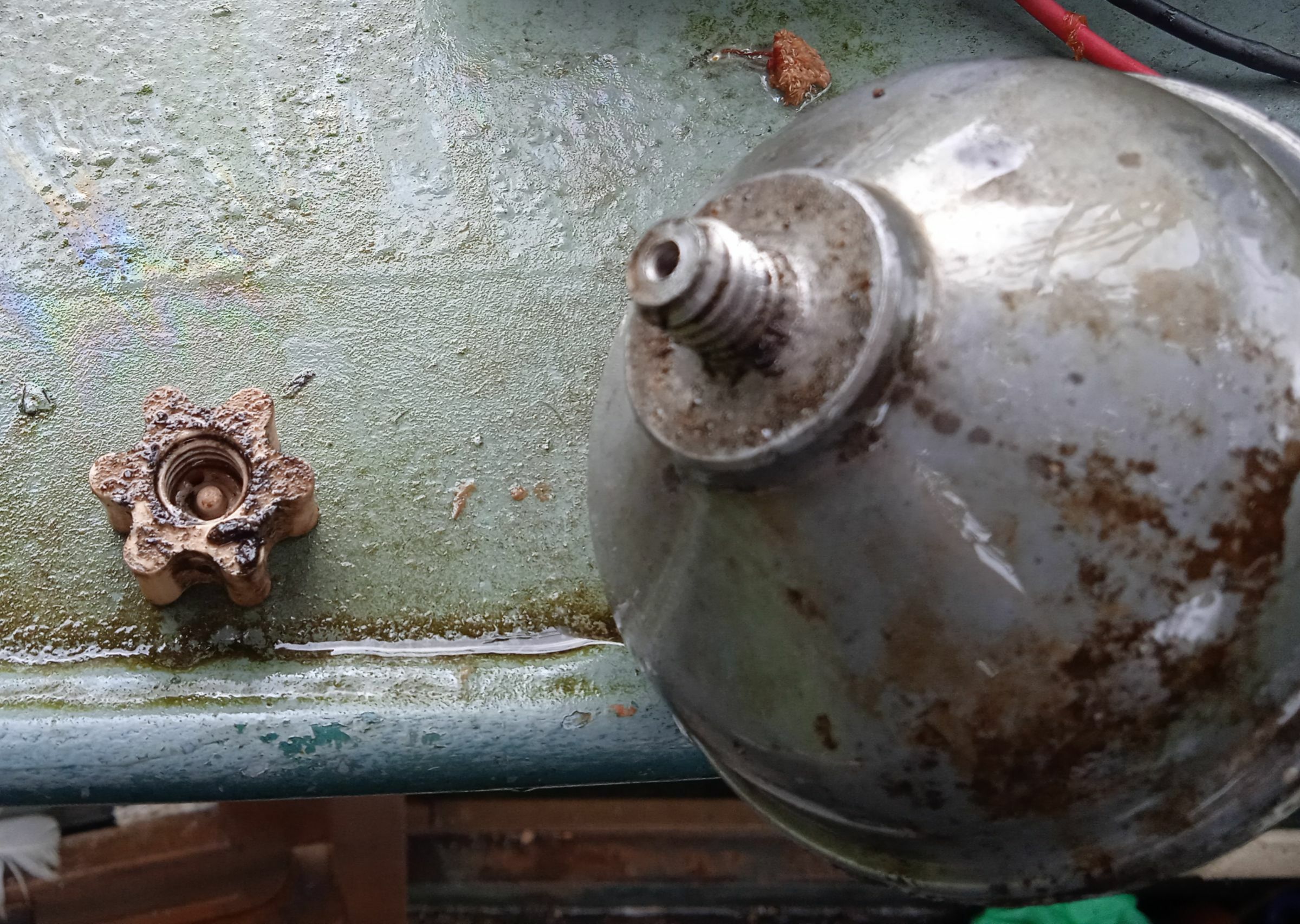

  6. I've ordered a bowl with no drain. Whack that on job done. Then put the original one back on and die in an awful inferno which also kills 27 children on a towpath walk expedition plus their teachers and the ambulance driver. It is about 8mm outside diameter but I didn't have my dial caliper to measure it. I suppose it does make sense it would be a normal thread size but there was something funny with it. The female thread type on the cav filter bodies is described as 7.8mm but they don't say what thread it actually is. 5/16 unc I guess. Stainless single piece dome nut ordered to cover all the angles. The problem is that 5/16 unc is not 7.8mm it is 7.9mm. This could be a silly thread I think. Someone must have established what is going on with these things. I know this is the opposite type but if this was a UNC thread why would they not mention it ? Seems a strange way to describe a thread. To me it looked more coarse than a UNC.

  8. The plastic cap has a little pin in the centre which locates into that hole so if it was drilled to pass the BS then it could never be used as designed. It doesn't rely on a sealing washer as designed.
  9. 4.2mm and an m5 tap might work Bit tempted to get a new bowl with no drain and leave this one unmodified as it is a very nice drain arrangement.
  10. That is an idea. I suppose just an M5 tap or something and a little stainless bolt would sort it.

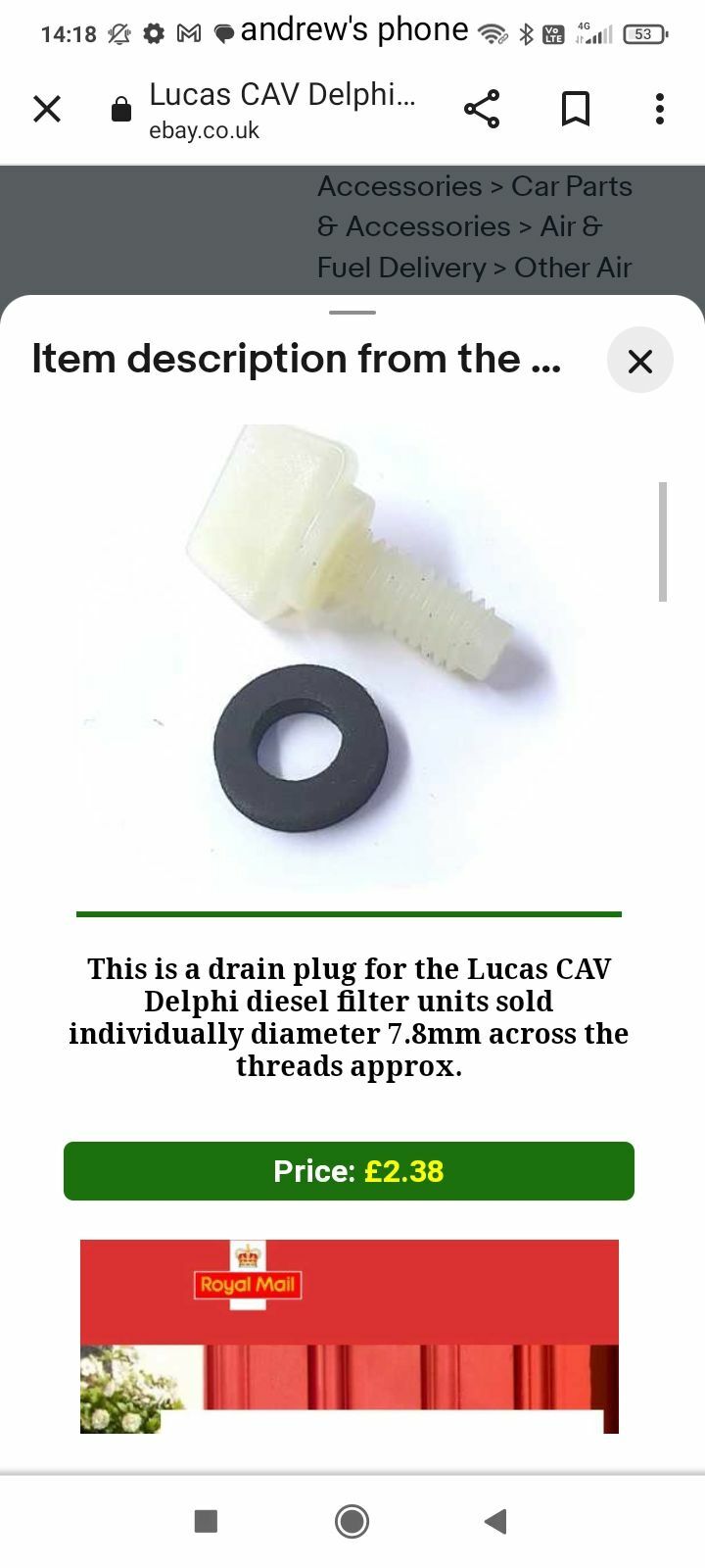

  11. This Has failed the BS inspection. It isn't a normal CAV type as the thread on housing is male. Does anyone know what the thread is and if there is a metal version of this as the BS does not want plastic. The filter body says CY on top of it. I wonder if I need a whole new filter body. Or maybe replace bowl with one without drain plug. https://www.ebay.co.uk/itm/183175795973
