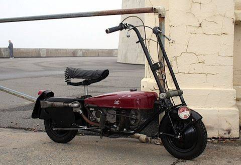

  21. Corgi Bike. my first, Bought from a retired female local council rent collector for 5/-.
