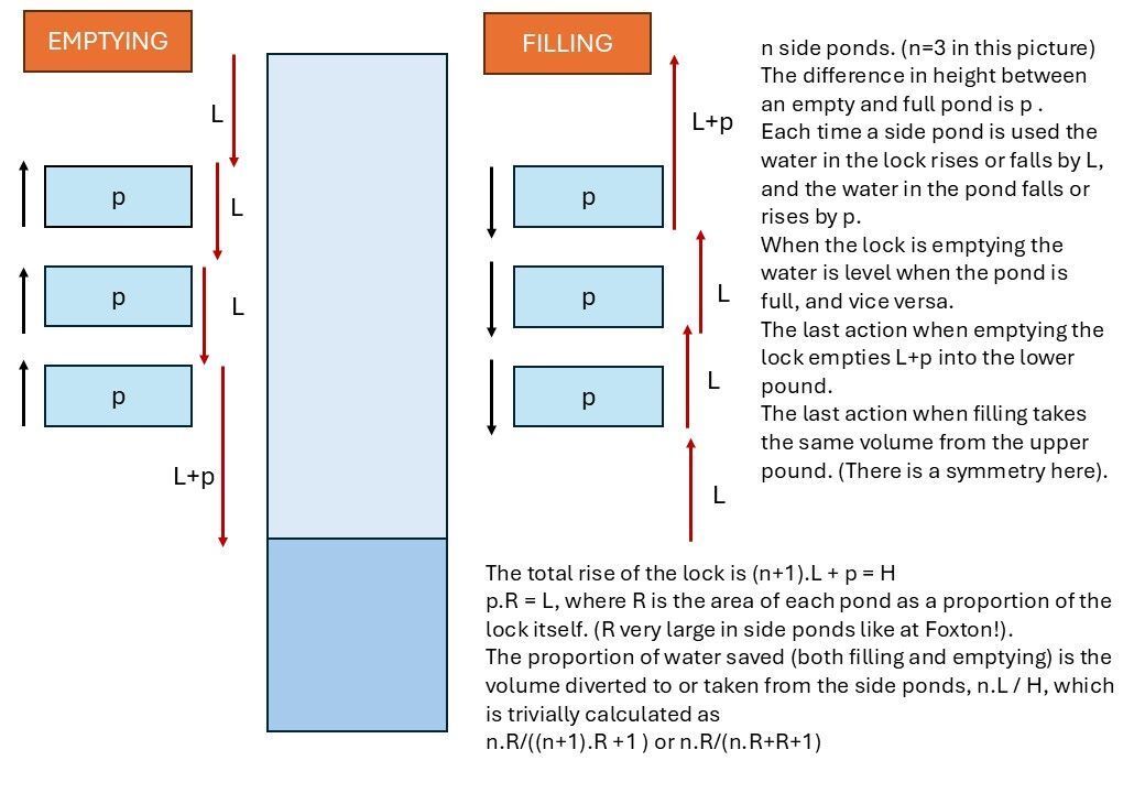

  5. I thought I would see if I could remember how I derived the formula, in case anyone writes to Canal Boat ...

  7. Yes, that is what it was designed for. It does assume the side ponds have the same area.
  8. I was rather pleased to see the second formula appearing in the latest edition of Canal World, in Martin Ludgate's article about the restoration of the side ponds on the Hanwell flight in London!
