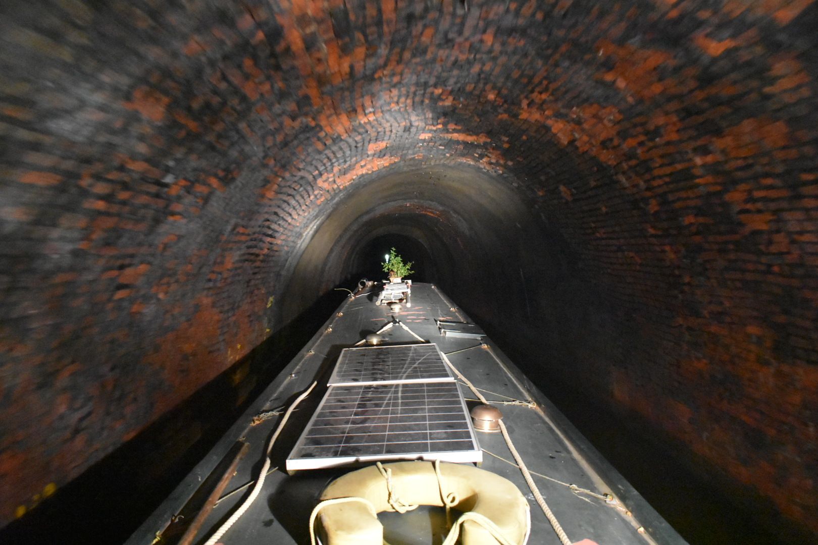

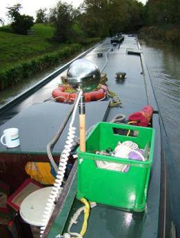

  2. I have my main tunnel light at the stern. That way it illuminates what you need to see - the position and direction of the boat relative to the walls - and not what you don't need to see (500 metres ahead). There is a low power light at the bows to avoid confusing oncoming boats. And here it is in Blisworth (no flash used!). When another boat approaches I just turn it to the right.

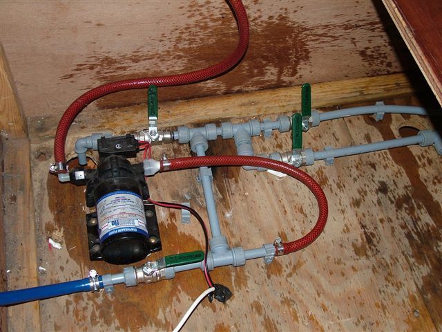

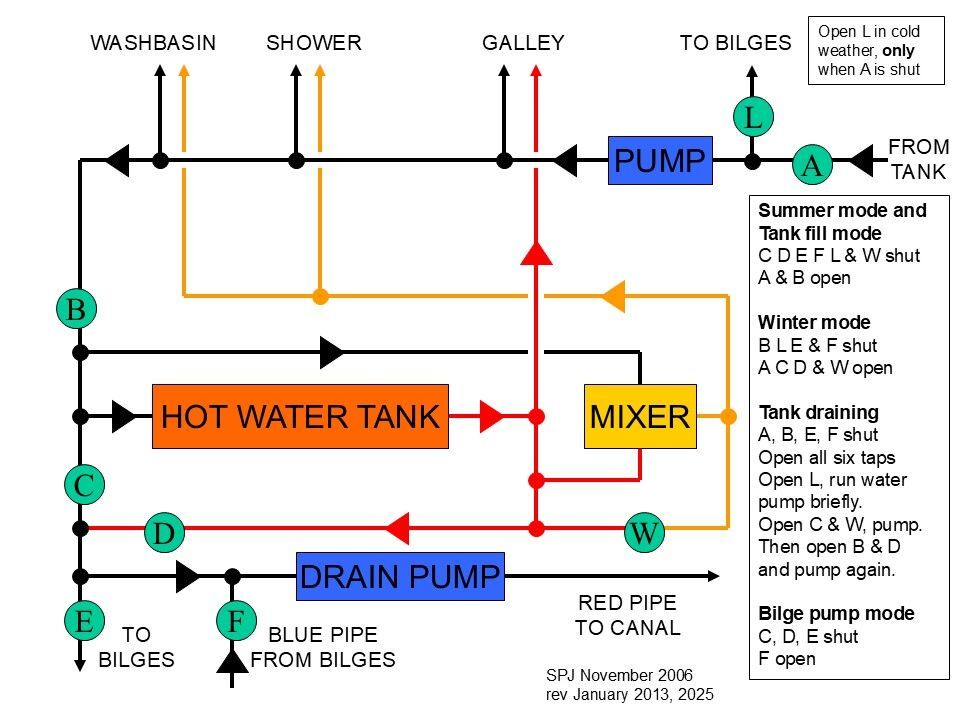

  3. I tend to drain mine in the depths of winter. I have added a pump that is connected to both sides of the calorifier. (There is also a valve W that goes round the TMV in the hot circuit). Here's a schematic. The drain pump can also be connected to a pipe to pump out the cabin bilges, rarely used. There is no NRV on the inlet to the calorifier, one has to remember to open the hot tap in the galley to let air in. Most of the draining is done with C open, and B and D shut. There is also a "winter mode" which enables you to run the cold water system but not the hot. It takes five minutes to drain the calorifier and five mins to refill it when I arrive on the boat And here is a picture of the drain pump, and valves C D E and F. I am sure you can work out which is which.

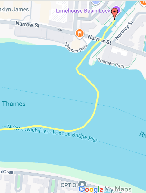

  11. I keep a good distance away from the pier. The yellow track here shows an arrival from upriver, turning to face upstream. and then drifting backwards to the Grapes to let half a dozen other boats lock in ahead of me, and then entering the lock. (The other tracks show a departure for the Barrier (red), travelling past on the way up to Brentford (white), and then departing again for Teddington (black)! All part of the SPCC cruises this June).

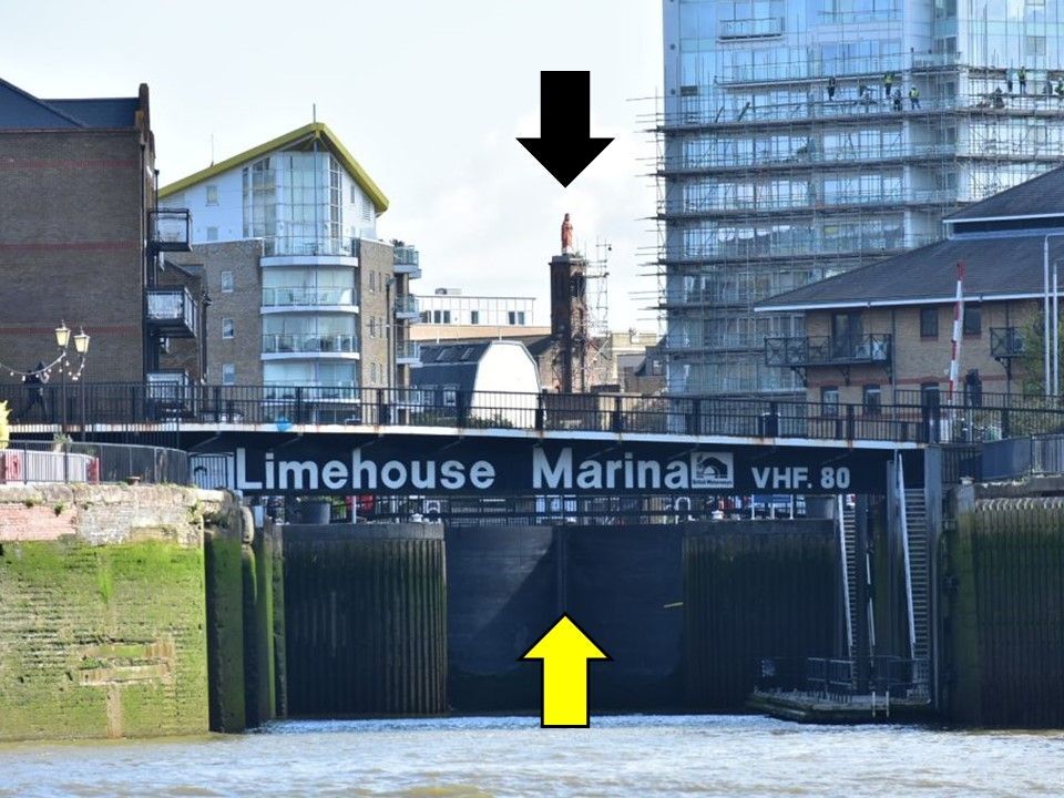

  12. Yes it does take a while to get used to the fact that the water is moving, and that the direction the boat is pointing can be very different from where it is going. Here's another track (over the ground), when I had to delay the crossing a bit to avoid an inbound Uber boat (the video I posted earlier), For this direct approach the (Catholic) church and the "M" of "Marina" on the bridge give a handy transit line. Again some people can handle that concept and some people can't.

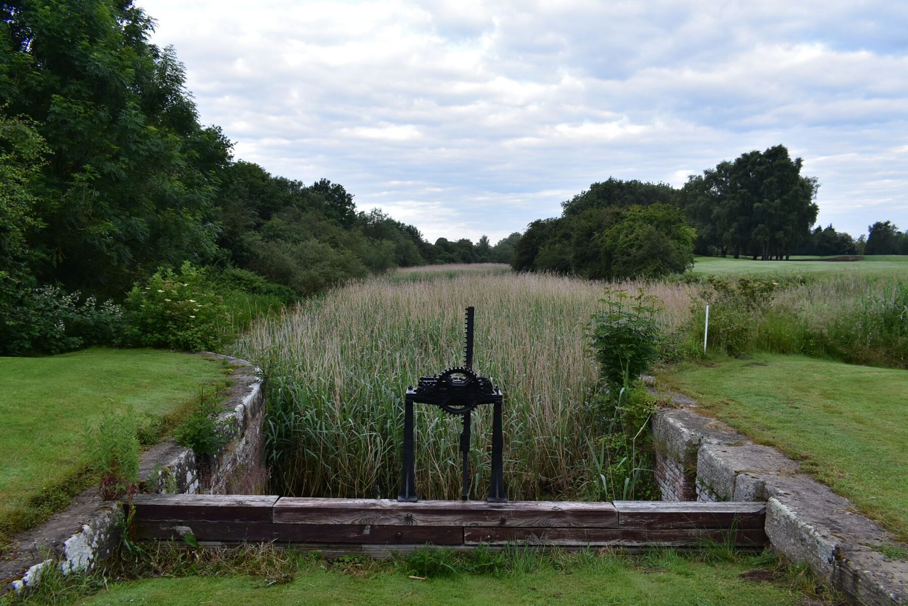

  18. I am not sure I follow all the above, but here are a couple of photos of the lock that is now part of the golf course. Somewhere near Cowbridge lock!
