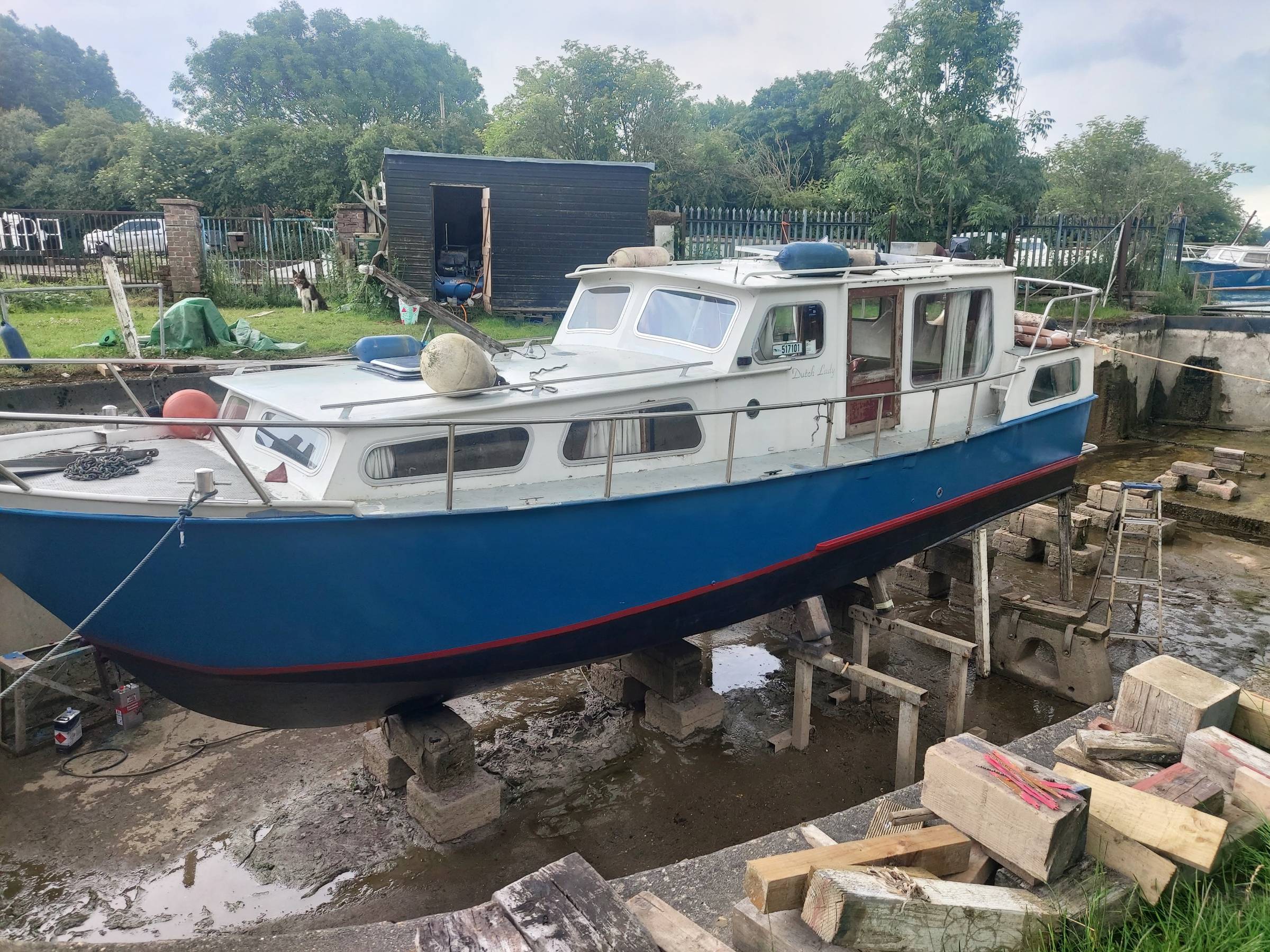

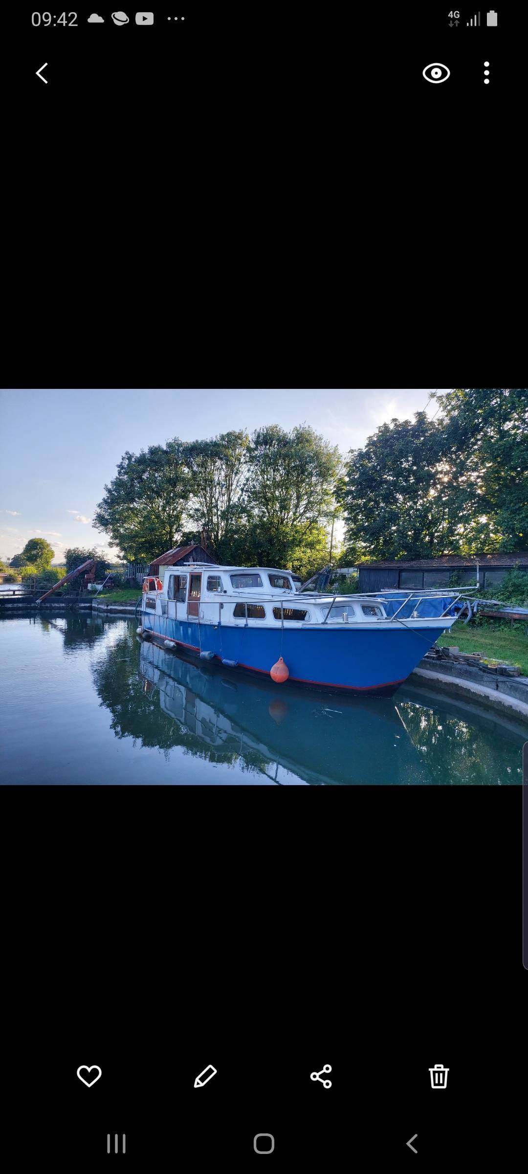

  48. So a picture of the finished article And another floating, my new moorings are about 20 yards away In the end the bottom was done in 2 tye coats as I couldn't clean everything off and then 4 counts of anti foul a black colour, the red above the waterline is an old tin that a friend had which was fast drying and hard wearing he said. We still have the upper steel works to do in cream I think with red highlights at the raised edges
