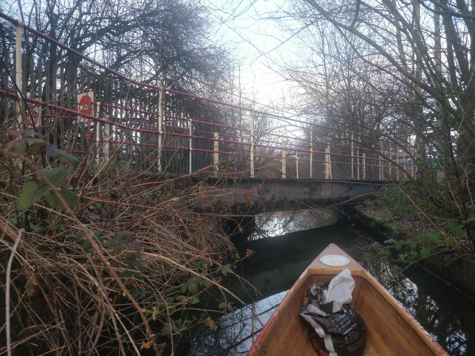

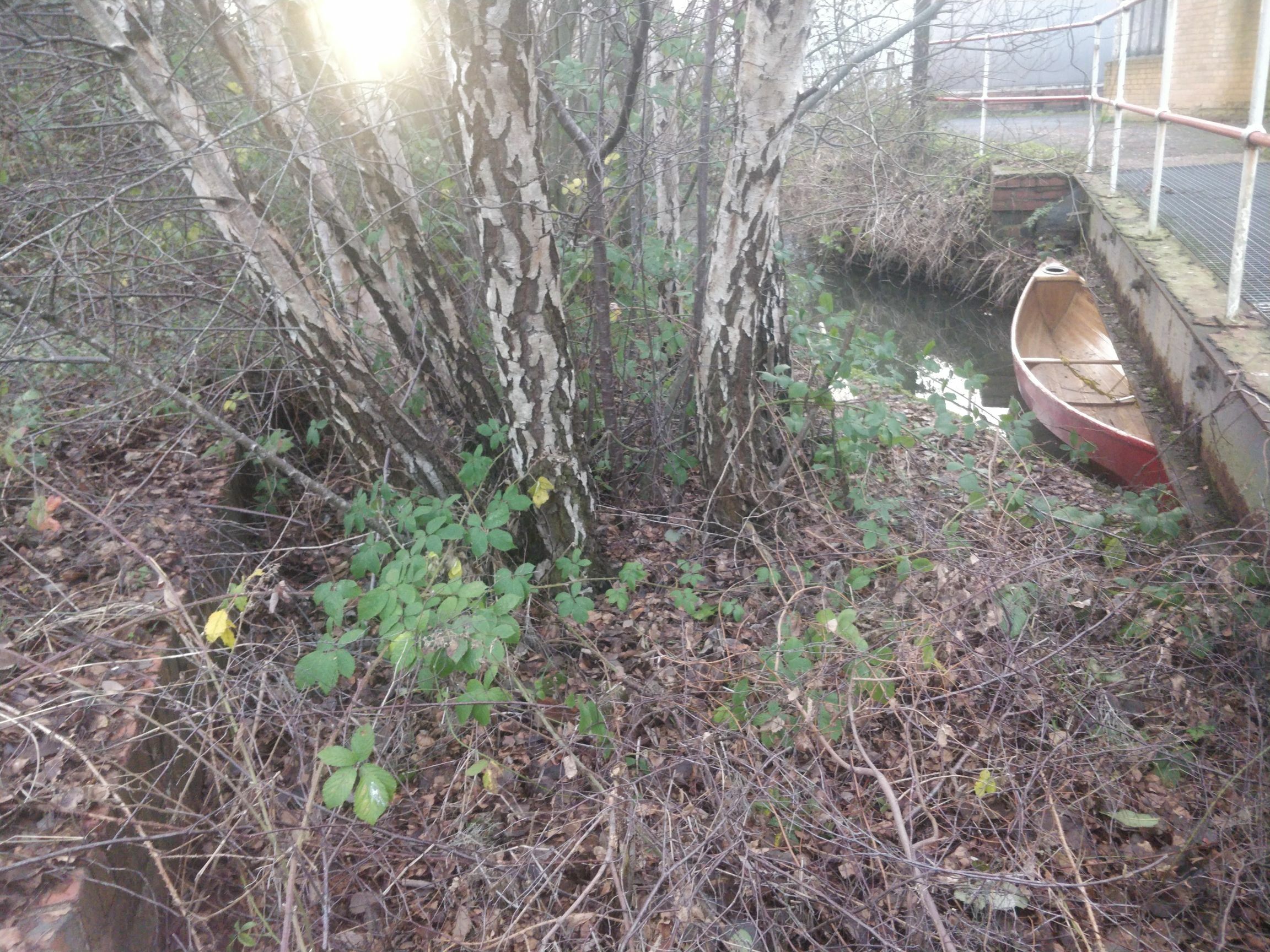

  30. A much smaller railway swing bridge is located on the Tat Bank (or Rood End) branch of the BCN. First is 1937 photo, from the "Britain from Above" collection via Duncan Moore's excellent website https://lostbcnimages.blogspot.com/2022/05/oldbury-and-titford-area.html Other two are mine. The bridge still exists, with swing mechanism intact if rusted solid, but can't be reached by narrowboat. You can visit it by canoe. There's no access by land as it's within the BIP site.
