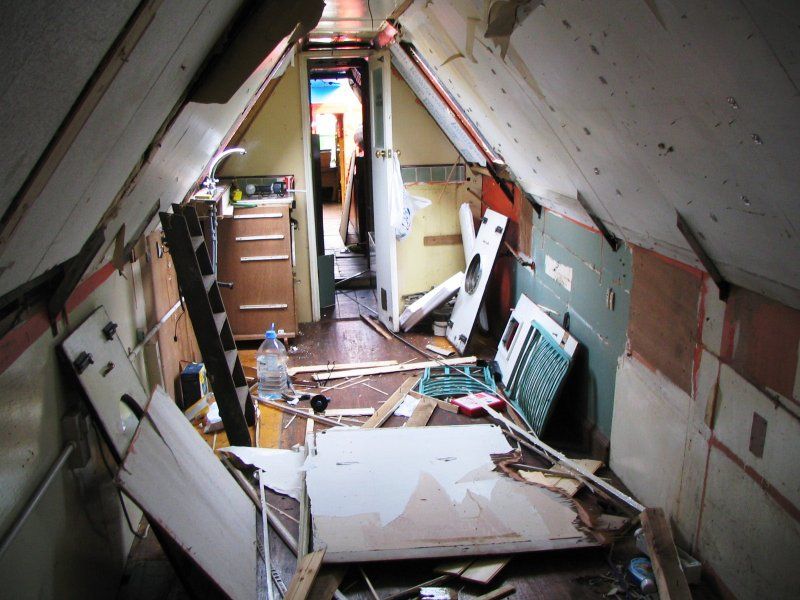

Posted Image
Before . .

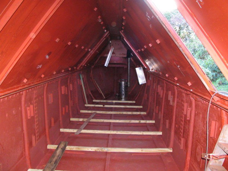

Posted Image
during . .
Posted Image
and after.
Just to give you some idea of the cost and the work involved. It took about 10K to fit out the butty from scratch, including kitchen, bedroom and and bathroom. It's a pretty simple fit out but it took me about six months to complete it, working about three days a week. In addition to this I had to do a lot of work on the back cabin.
When I did a similar fit out on the motor this took me eighteen months working on it at weekends and holidays. This conversion was more expensive because I splashed out on some rather nice second hand eucalyptus for lining out which added about 5k to the cost.
In addition to the fit outs there was, of course, additional expense on steelwork and the engines.
  • 0

#11 alan_fincher
alan_fincher
    Long Standing Member
  • Members
  • PipPipPipPipPip
  • 32,133 posts
  • Gender:Male
  • Location:Hertfordshire
  • Boat Name:"Sickle" & "Flamingo" (both built 1936, by W.J. Yarwood and Sons)
Posted 02 May 2012 - 09:46 PM
Jim
You appear to have bits of some kind of "flat pack" automatic washing machine in that first picture!
Posted Image
  • 0
