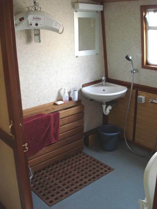

We have a wet room, mainly for accessibility reasons, but its very easy to keep clean.
Posted Image

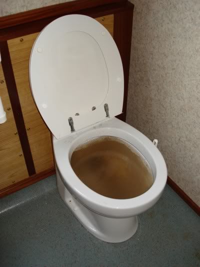

Yes, any time..
We have just the job for you...
Posted Image
Its not what you think.
We think a cleaner tried to flush a J-cloth down the toilet then emptied her mop bucket in it.
