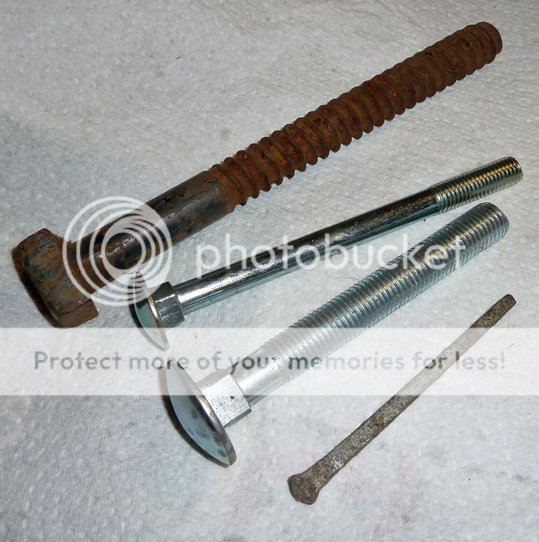

OK, three types of fastener, grabbed quickly in odd sizes:-
Posted Image
Random sizes, Coach Screw at the top (conventional square head, the most common type):
Two sizes of Coach Bolt:
Rose head Spike or Nail, commonly used in building wooden boats.

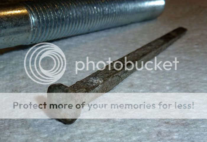

Rose Head spike in close up:-
Posted Image

Those are Coach SCREWS. I must admit I've never come across them with Diamond heads. A Coach Bolt is a BOLT with a domed head & a thread for a nut.
I reckon the one you've seen had a Rose Head spike in it ;)
I'll get a picture later & post it.
Tim
Whether they are called screws or bolts really matters little, I think. But when I worked for BT they were always known as coach bolts which is why I refered to them as such.
The device in the mop at Stoke Bruerne did look like your last illustration. I have not heard of Rose Head Spikes before and I apparently eroneously though the fixing device was a diamond head bolt. You learn something every day. Possibly if rose head spikes are in short supply a diamond coach screw could be used.

I would have called the top one a coach bolt, the next two roofing bolts - and I haven't come across the last one, so I don't have an alternative name for that!
Must be a regional thing! :cheers:
A roofing bolt has a slotted head (usually a crossed slot) and no square under the head, which is there on a Coach Bolt to grip the wood so it doesn't turn when you tighten the nut. Roofing Bolts are usually 6mm dia, occasionally 8mm. The two bolts in my pic are 10mm and 16mm.
Hex head Coach Screws here

Ray, the rose head spike was preferred as a coach screw could unscrew if the mop was spun the wrong way. All the coach screws shown here are the nice old imperial 4 sided ones, nowadays they have a metric hex head.
  • 0

I was taught at a very early age that screws are not very good into end grain, nails are better. Of course, if driving a substantial spike into a not very substantial mop stale, you have to be sure to get the pre-drilling spot on! I have salvaged one or two split stales by reinforcing them with metal ferrules.
Tim
