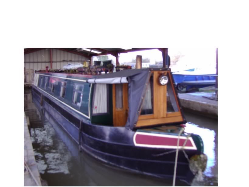

Okay, this is the start. We became the proud owners of nb Imagine on Sunday. I thought I'd start posting a getting started blog here for a number of reasons. It'll keep me from despair, I hope, as I check how much progress I make. It'll serve as a guide for other new-starters and should provide you all with a good laugh as you spot my elementary mistakes. I've started keeping a spreadsheet on costs so far as a result of a discussion on living costs so if you'd like a copy drop me a PM and I'll email you.
The summary
nb Imagine was built in 1993 by Delph Marine. She's 58ft and has a 10/8:6:4mm spec and a newish (late 2002) Beta 43HP Greenline engine. No central heating but 3 rads supplied by a back boiler on the Squirrel and a manual pump. Hot water is supplied by a calorifier and Rinnai heater and she has a 1.8kw inverter. The cratch was added a few years ago and is in good condition as is the stern cover. She needs the bottom bearing on the rudder sorting out, re-blacking and bigger anodes; I also need to check the stub pipe penetrations to the hull for decay and investigate a leak in the engine 'ole. The fitout is oak and very tired but there's no sign of any major damage or rust even around the windows and the external paintwork is a slightly faded red but in good order (no flaking) with any scrapes primered over winter. She generally needs tidying up and re-painting/varnishing before Ellen and I move aboard in May.

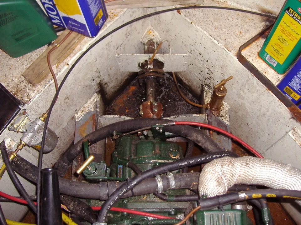

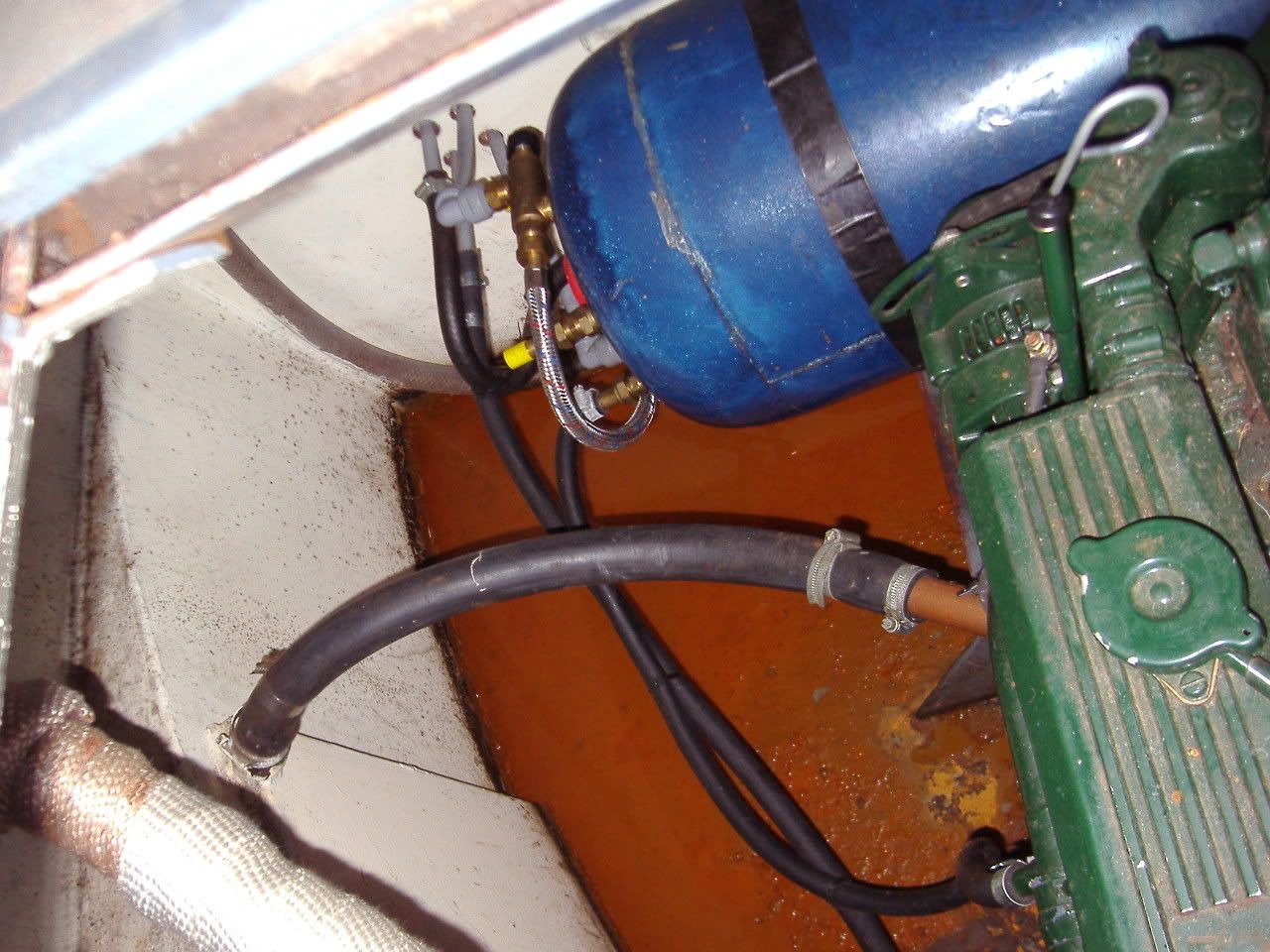

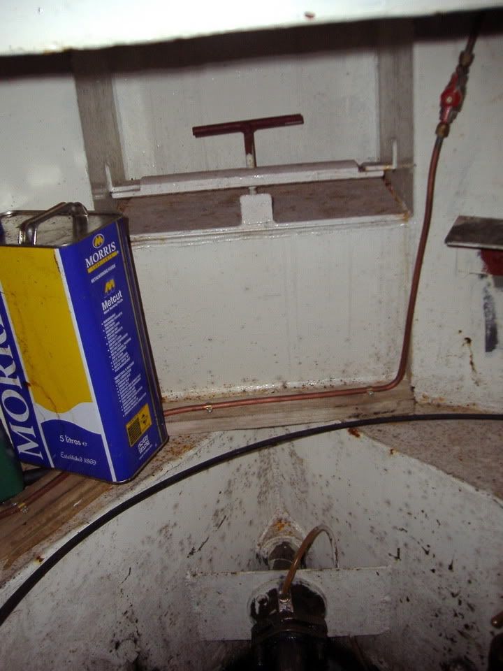

Steelwork and complicated stuff
As my skills as a welder and electrician are totally non-existent I've made a 'throw some money at this problem' decision and asked a boat engineer to i) do the rudder bearing, ii) the stern gland, iii) tell me how the electricity works and suggest sensible changes to make it work safely and iv) do the anodes and the blacking.
He's also going to show me how to re-pack the stuffing box in future but the critical part is sorting out the electricity. There's no wiring diagram which makes me uneasy at the moment, because the electricity is supplied in a number of different ways none of which make much sense. On the cut it's simple I think. The Beta charges both the starter and the battery bank (which exists at present as two batteries supplying the inverter, (will be three next week) and one supplying the 12V circuit). When the batteries discharge; no electricity, no problem. In the marina, it's more confused. There's a landline supplying 230V into which a car charger is plugged. This is connected to the batteries (which are 6V) by crocodile clips to the terminal. Presumably, then the 230V supply is via the batteries and inverter but I'm totally confused. Worse, the whole of the landline and the plug connection is exposed to the elements, protected by a worn out Sainsbury's plastic bag, balanced on the storage locker at the stern end. It may be the most amazingly safe system ever devised; I wouldn't know, but I don't think it'll stand up to the sort of rough love a seventeen year old is likely to give it as they race round the boat and that's my criteria. Remember - electricity kills so I've unplugged the landline.

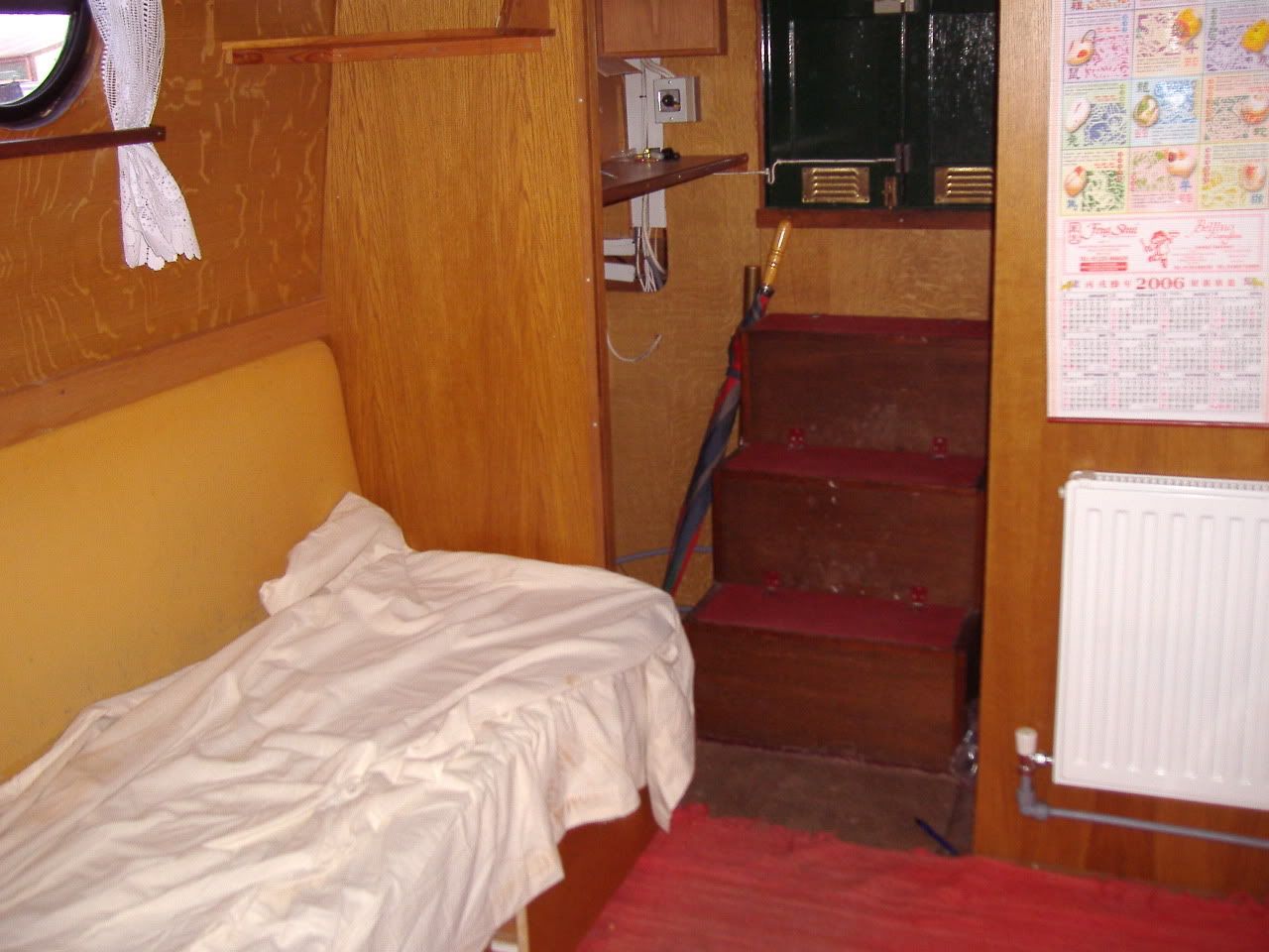

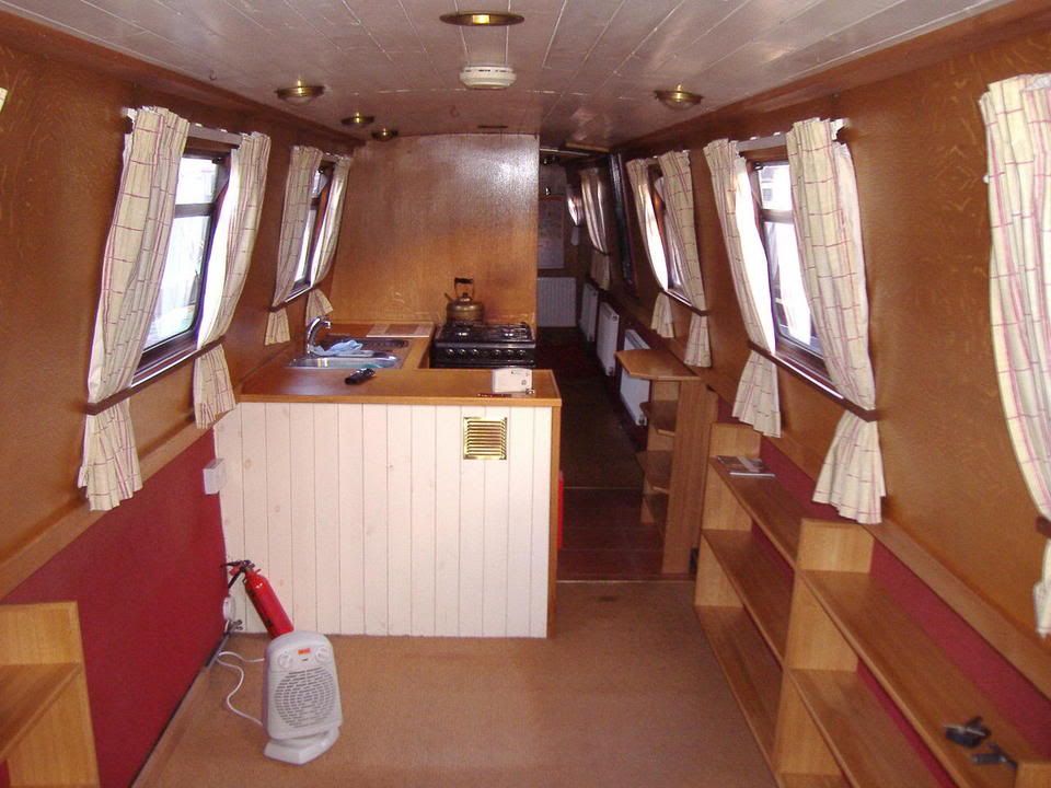

Inside
Working from the stern there's two glory holes one of which would serve as a hanging space with enough room to fit a washing machine in should I ever get the electricity sorted out. On the other side of the rear steps is another space which would benefit from having some shelves fitted for Ellen's storage (or mine if I can swing it - nearly 2000 cds to store somewhere!). Both need some repair and repainting as they're pretty grubby, filthy really.
Ellen's berth is a single/convertible double in a rather sad state of repair. She's got portholes and oak finish everywhere, the carpet on the side walls is dark red and damaged, and the look is completed by bare foam mattresses. It's really dark and a little dismal so I'm going to i) rebuild her berth and recover the foam mattresses, ii) sort out her overhead cupboard doors so that they close (and stay closed), iii) replace the carpet with t & g and try to persuade her that the tatty oak veneer will be improved by liming or repainting.

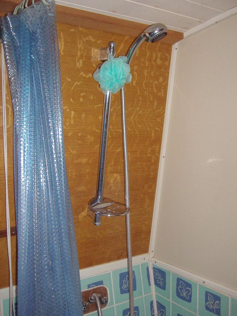

The bathroom is also showing it's age. I've replaced the porta potti with a new one (excitement), the tiles are in good order but unspeakably tasteless and the bath is elderly and scratched. Short of some re-painting though, it's going to have to wait until next year.
My berth is basic but it has the side hatch. The mattress needs replacing but the storage under the bed is vast and with the help of wheeled storage boxes will more than suffice. The oak veneer is in good nick in here; just needing a little re-varnishing.

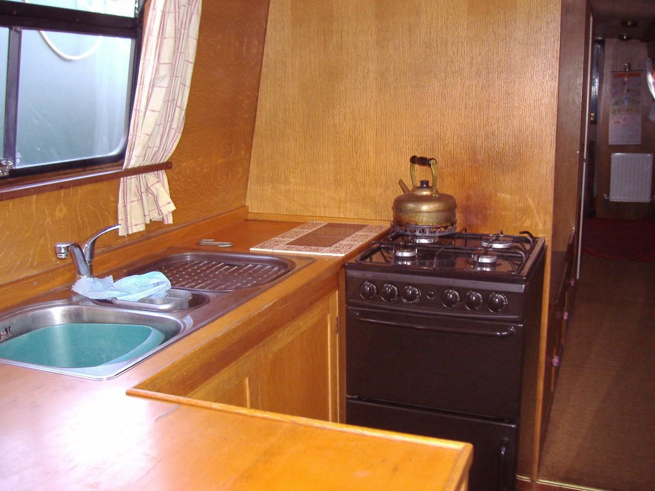

The kitchen needs all manner of stuff doing to it at some time in the future, but at the moment it works so it'll stay as it is until next year. (Needs a decent cooker though!).
The saloon is fine, needs re-varnishing, new rugs and downlighters. The manual pump needs attention and the stove outer flue needs re-bedding between the pipe and the top of the stove (I'm hoping black fire cement should do the job tomorrow). Eventually, I'd like to replace the carpeted sides below the gunnels with t & g but not yet. We do need new curtains (and lots of them) so the sewing machine is out already.

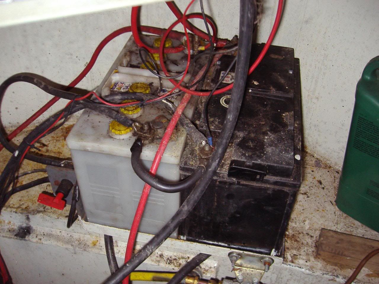

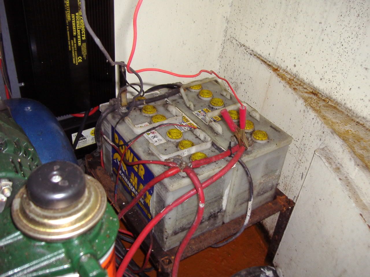

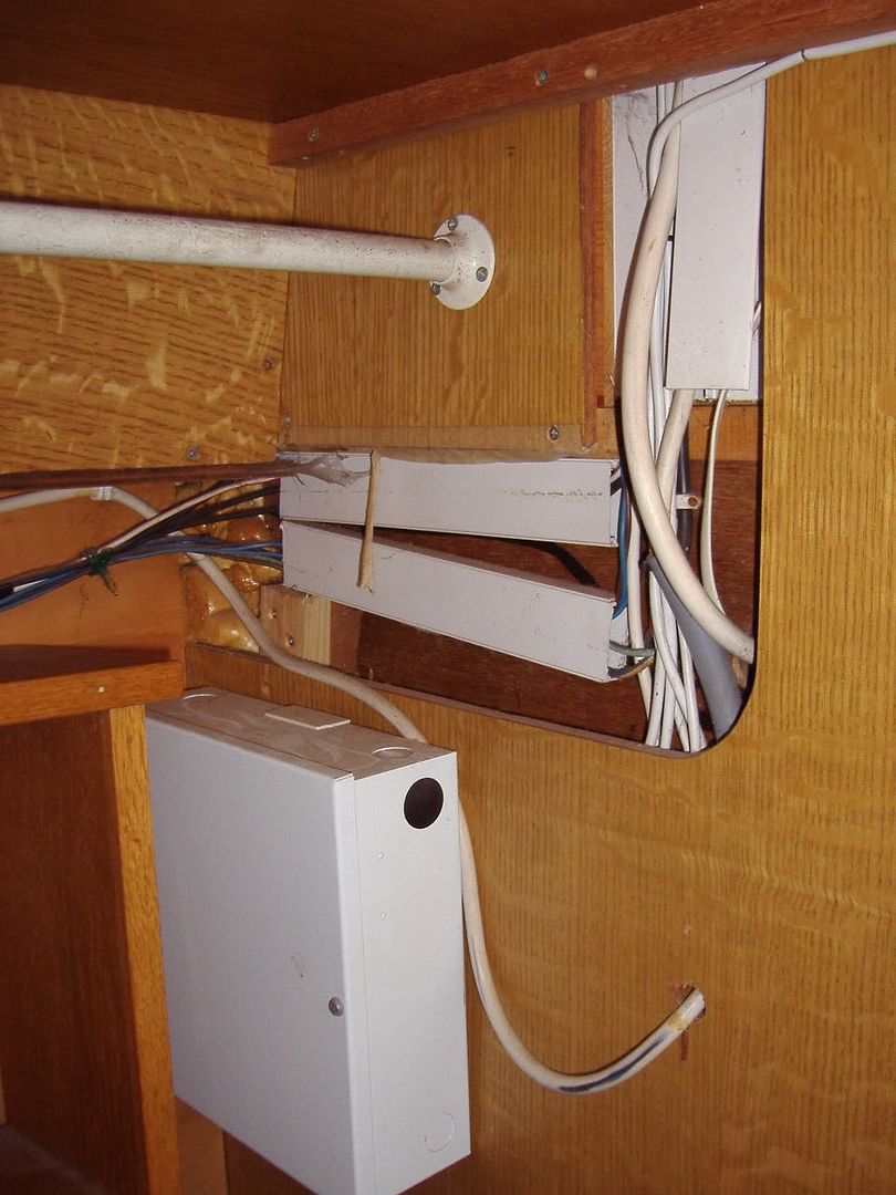

Wiringwise, i think your right, the first thing to do is get a wiring diagram drawn up.
- Even if its just the "core" of the system, rather than every single plug/socket, that just about enough, then you can set back and look at it.
Thats what i did for our boat about 2 years ago.
- I had a rought idea, but i didnt really know eactly what was going where, so i drew a picture, using my grandads knowlage of the boat, and what i could see/get at.
- I couldnt trace the whole lenght of wires, so i started off looking at the battery area, where the dometic batterys, and the mains the charger where. And noted down all the wires (thick blue one, 3 thin black ones, etc) where the went to on the batterys/charger, and in what direnction they dissappered to!
- Then i did the same at the 12v distubution box, where most of the varous meter are, etc.
- Then i started peicing the bits together. Ahh, that thick blue one goes to the -ve of the alternator, those three thing black ones are for the chargers display, etc,etc.

This is nb Imagine in the dry dock after survey ......
Posted Image

and this is the saloon ......
Posted Image
and reverse view .......
Posted Image
NB ample shelving for cds (but still not enough by a a factor of about 10 or so)

The galley
Posted Image
My berth (looks suspiciously tidy; soon have that covered with stuff I reckon) .......

The lav (featuring the tiles Ellen said had to to go. She's coping with the idea of a Porta Potti by delicately, but ostentatiously ignoring said item). Please note careful co-ordination of curtain, tiles and spongy thing; essentials for any bathroom.
Posted Image

Badger the Bodger's favourite place. What does all this stuff do??????
Posted Image
That's the fitout stuff - should keep Ellen quiet for a couple of days sorting that lot out (I wish).

Okay, round 2; down the engine 'ole (argh!)
Posted Image
And looking good in every way, the red stuff is light rust not red primer as Ellen suggested
Posted Image
The totally inaccessible weedhatch (I just can't quite compress my body that small to get in there, so it looks like a job for Ellen!)
Posted Image
This is a job for a boy I think
Posted Image

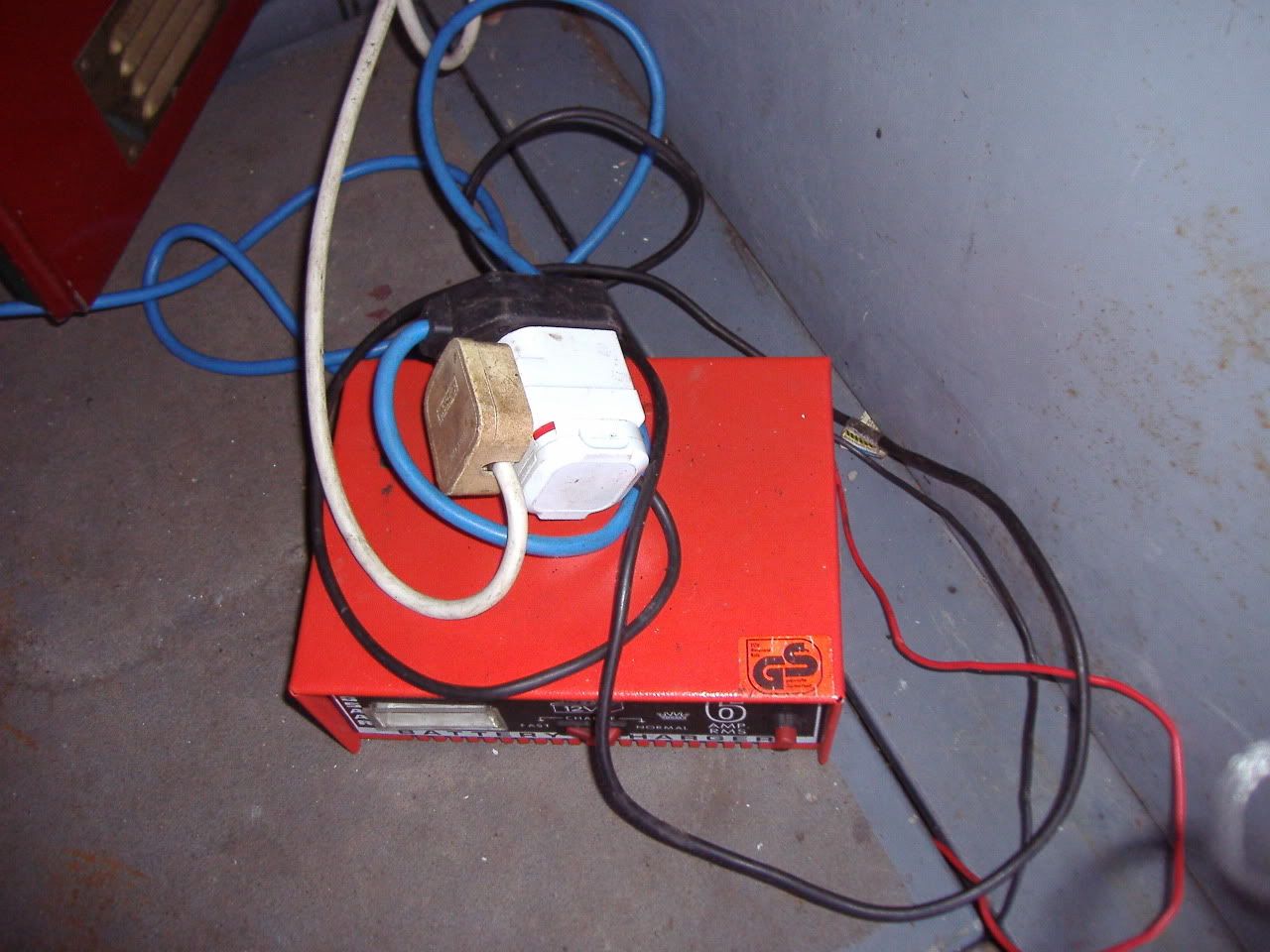

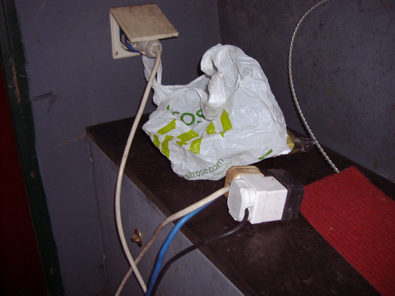

And finally the landline connection (which isn't as bad as I thought but still not right somehow) and I misled you all - it was a Waitrose bag not Sainsbury's, clearly better quality!)
Posted Image
Posted Image

Looks like a nice boat but not had a BSS inspection for a while I suspect, those batteries should be clamped down in some way.

I agree with Ellen about the bathroom tiles. But apart from that it all looks really good. The electrics remind me of my first boat - especially the central heating pump arrangement - but it didn't take much to get mine sorted out and I'd be willing to bet that yours won't take much effort to do the same - although I must say the Waitrose bag looks to be in rather poor condition and I'd definitely recommend replacing it at the first opportunity.
