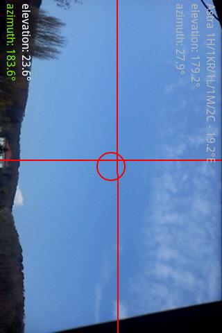

Ignore the sat finder and a magnetic compass on a steel boat. If you have a smart phone get one of the many free sat finder apps. They will give you a point in the sky for dozens of satellites as well as the angles in figures.
If you are not getting power to the sat finder, you aint going to get a signal no matter how much you point and elevate. I still think you have a connection problem and would re check all. Once the finder is live, then you can be assured the signal will get to the receiver. We use the signal strengh meter on the tv more than the sat finder. Our initial problem was a dodgy connection. Coaxial connectors are primitive and prone to fail in systems like these.
I use this app when I occasionally need to as I can mostly do it without
When you get the phone crosshairs facing the spot in the sky the circle turns green.
This is overlaid on a image from the phones camera.
Simply brilliant.
Simply brilliant.

Blackrose . . . . I hope this helps
