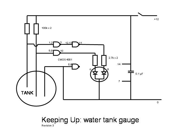

If you know someone that can do simple electronics you could make a water tank indicator like mine. Dimensions here are for a tank that's 12 inches deep.
It consists firstly of a length of 3-core mains flex, with the sheath slit open for an inch by a Stanley knife at 4 inches and again at 8 inches from the end, so you can get at the wires inside. At the end you remove about a quarter of an inch of the insulation from the green/yellow wire. Then at the 4 inch point you cut the blue wire and remove a quarter inch of the insulation, and do the same at the 8 inch point the same for the brown wire.
You now have something that looks a bit like an attempt to prepare for wiring up a long straight mains plug. This is your water-depth sensor, which you need to poke into the tank until the end is just above the bottom of the tank. I did this by making a small incision in the plastic filler hose, then poked in the wire and sealed up with silicone sealant. So when the tank is one-third full, the water makes a contact between the green/yellow wire and the blue wire; when it is two-thirds full it also connects to the brown wire.
Now the elctronics; a single CMOS chip can detect when the wires are covered, and light up a red/green LED so that it shines green if you have 2/3 tank or more, orange if you have between 1/3 and 2/3, and red if you have less than 1/3. On 'Keeping Up' the rule is "Green you can do what you want, Orange you can do anything except take a shower, Red you use water only for drinking or cooking".
My first attempt failed because I had the unit 'On' up all the time; the small current in the sensor wires electrolysed away the copper after about 6 months. So I put a press button in the 12-volt line, next to the LED, so when you want to check the water you press the button and see what colour light you get. That version has worked for over 10 years now with no problems.
The electronics circuit is simple; it just uses a couple of 100k resistors, a couple of 1k resistors, a 4584 CMOS chip, and an LED. Total cost less than £1. I've sketched it from memory here.
