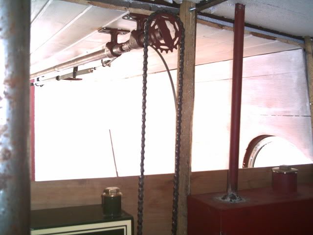

Diesel filler mk2..
Posted by casper ghost, Mar 9 2010, 02:39 PM
Well, got a length of mild steel tube which we had laying about and made the bend by cutting at 45 degrees and joining. All welded well, tested with diesel and no leaks to be seen so all ok..
